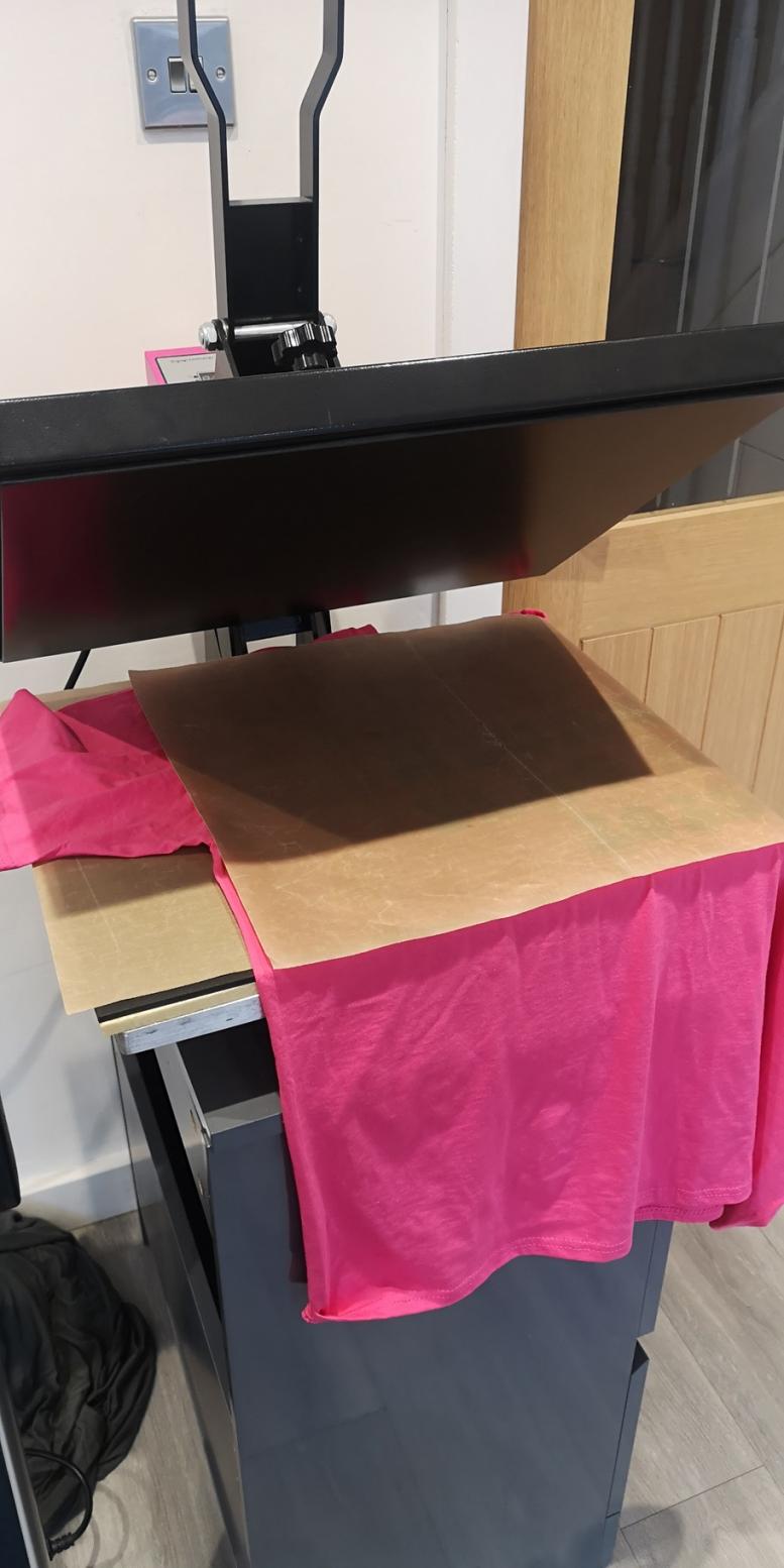

Heat press is an ink experts 50x40cm flat bed clam press.
Process
Place the t shirts onto the lower platen (not threaded as most medium and large t shirts don't particularly stretch over it)
No seems or anything in the press area.
Pre press the t shirt for a few seconds to take out moisture, front and back.
Press the vinyl onto the t shirt with a thin Teflon sheet on the top, for 160 degrees, 15 secs, hot peel.
Remove film and re press again for a further 5 seconds with a Teflon sheet on the top.
Turn the t shirt over and do the same with the text on the other side.
Hang up on a hanger and the next day put them in a carrier bag to take to work.

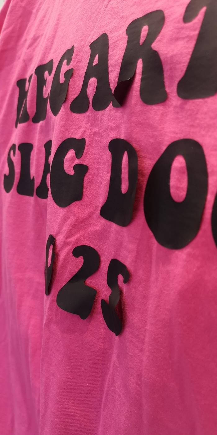

I have given the t shirts to my friend to try on, and the letters on this particular one basically fell off in front of me.
Totally embarrassed (and slightly stressed) I said I would re do them all.
Theres a couple where the edges of the letters are not fully stuck.
Although last night they looked completely fine.
Can you see if there's anything wrong with the procedure?..
Should I stretch the t shirt straight after the pressing??
Is it the pressure, being too light?
When removing the film, on this particular t shirt i do remember i had to do it a couple of times as a couple of the letters were peeling with it.
So i re pressed, adding a 1/3 or 1/4 turn to the pressure setting.
But it looked fine before taking into work this morning.
Any advice would be appreciated.
[ATTACH=CONFIG]7417[/ATTACH][ATTACH=CONFIG]7418[/ATTACH]

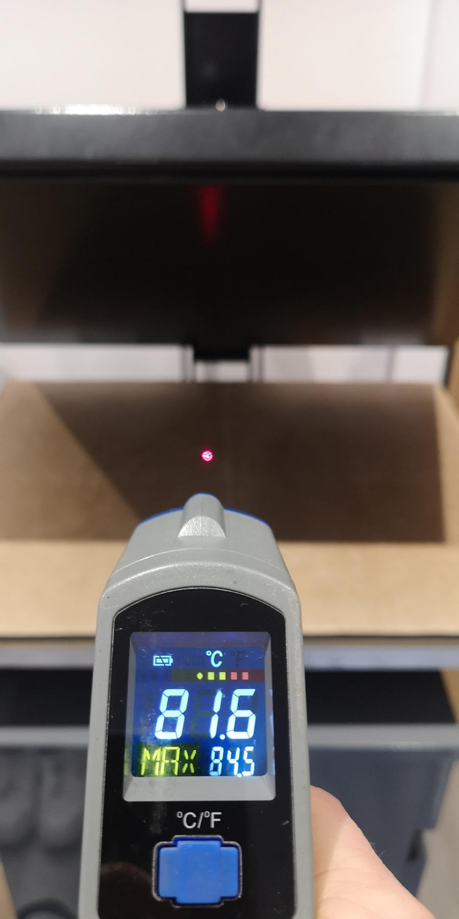

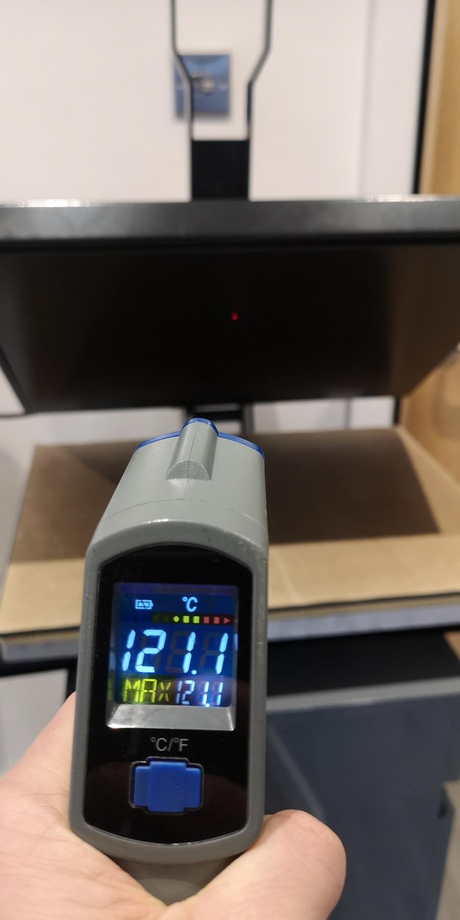

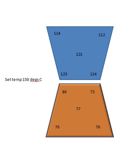

I have previously done checks with a heat gun to check the temp across the top plate (basically comparing it to my old cheap press)

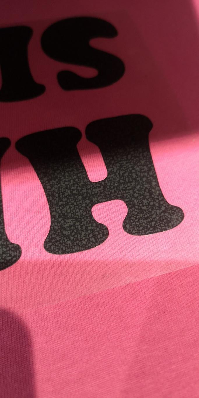

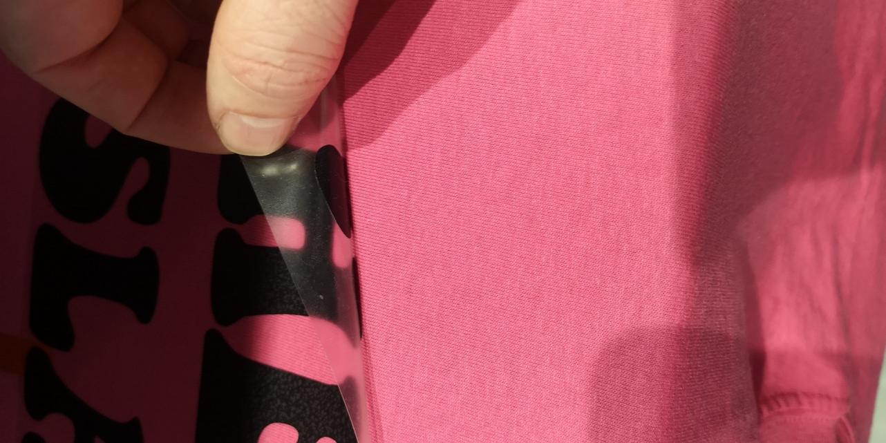

This morning it seems on this XXL t shirt, the vinyl is easily peeling off with very little effort.
This particular shirt was the one with the letters falling off yesterday.
Doing a pull/stretch test with a little bit of force is lifting the letters....
Yesterday i threaded the t shirt over the press again and gave each side a press again, so it seems this particular shirt is still not allowing the vinyl to stick as it should be doing.
The other 4 shirts seem relatively ok, some very slight peeling at the edges, concerning but not my biggest issue right now.
But a stronger pull test on these medium and XL shirts may lift the letters off.
Having done a slight pull/stretch test [ATTACH=CONFIG]7419[/ATTACH]

Possibly a faulty batch? The issue I had with cold peel instead of hot peel was probably a picking error in the warehouse so didn't show on the invoice.
Are you printying front and back? If you are without threading the shirt it could be that the second pressing is effecting the vinyl from the first pressing. I would say the only way around that would be to do a 5 sec tacking press on the front (without peeling) and then flip the t-shirt over and press the back print for the full 15 secs. Go up to 165c and increase the pressure.
Did you do a wash test? Some vinyls stipulate no laundering within 24 hours of pressing.
The best way to check if it is faulty vinyl is to cut a small piece and apply it to a waste t-shirt. If it sticks ok to the test shirt then it is the double pressing causing the issue.

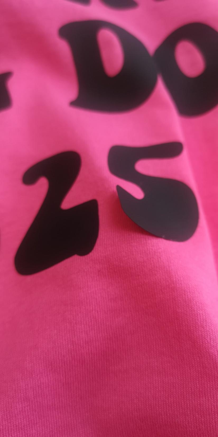

So now I have printed a new one, step by step from their own instructions, and increased pressure to medium-high like their email asked.
pre heat t-shirt
I threaded the t shirt over, pressed for 15 secs, and during the hot peel, the letters began to peel with it. (see photos).
So hopefully this rules out the pressing double sided issue, and PW66 is correct, im not helping matters by pressing the first side for about 40 seconds.
So that is one lesson learned i hadn't thought of.
So i will head there tomorrow and take a sample with me.
[ATTACH=CONFIG]7421[/ATTACH][ATTACH=CONFIG]7422[/ATTACH]
- vB_ID:7422
- Letters peeling off during hot peel.jpg (97.53 KiB) Viewed 2794 times
- vB_ID:7421
- How vinyl looks when hot 160 degs 15 secs.jpg (94.78 KiB) Viewed 2794 times

Just to provide an update on this.
I got some new hotflex vinyl from MDP to eliminate this being the issue.
Printed one or two more t-shirts but still having issues, so im now leaning towards the heat press being the issue.
I have checked the pressure using a piece of paper and ensuring there is some resistance when pulling it from a closed press.[ATTACH=CONFIG]7423[/ATTACH][ATTACH=CONFIG]7424[/ATTACH][ATTACH=CONFIG]7425[/ATTACH]
Set the heat press to 150 degrees C and when it reaches this temp, i have taken a reading in all 4 corners and the middle of top plate.
Mixed readings from 114 (top left), 112 (top right), 123 (bottom left), 114 (bottom right) and 121 (middle).
Press the heat press down for 10 seconds and then i wanted to see what temperature was being transferred onto the bottom half.
Back left - 80 degrees, Back right - 73 degrees, Front right - 76 degrees, front left - 70 degrees, middle 77 degrees.
The top plate i would have thought would have been higher and not 20-30 degrees lower.
I assume the teflon sheet will absorb some of the heat being transferred but not sure what readings i should expect.
So maybe i needed to press at higher temp setting.
Should i increase the temp until the top plate reads 140-150 degrees?
Who knows.
Anyway, not sure if this helps anyone but just wanted to share my experience in case anyone has same/similar issues or further advice.

- vB_ID:7423
- Heat press temp check.jpg (17.54 KiB) Viewed 2794 times
