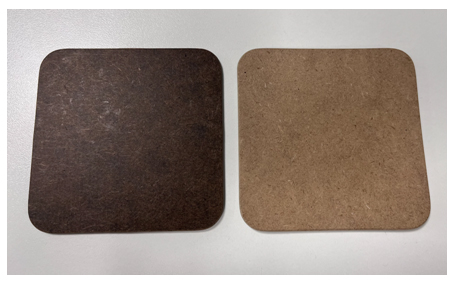

Re: Unisub Coasters / Placemats - Change to MDF
Old and new....
Do they press as well? Wondering about possible moisture issues.
Moisture issues was my first concern as well!Justin;154525 wrote:Do they press as well? Wondering about possible moisture issues.
I got this call yesterday from Xpres also... definitely concerned by the change. Looking at the image they sent over, it looks very similar material but obviously lighter. The main thing that makes the Unisub coasters to market leader, is (was?) the compactness of the wood fibres themselves, resulting in no warping after pressing. Fingers crossed there is no change in that department.
