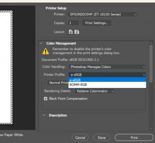

Anyone else found their ICC profiles have vanished after updating Photoshop to v26.1 ? I've tried rolling it back to an older version but it doesn't help. I've even tried putting the ICC profile in the "\AppData\Roaming\Adobe\Color\Settings" folder but it's not showing up. I don't know what to do and was hoping maybe somebody else had figured this out or knows what to do please? I've attached a screenshot to show what I mean. Normally in that dropdown I have a big long list of profiles, but now there are just two.
There are a handful of people on the Adobe forums that have said they've got this problem too over the past week or so, but they're just getting copy pasted replies that don't help.

What did Adobe support say? I know it takes 2 hours to get anywhere with them on live chat though ;-)

Got it sorted this afternoon - it is a windows 11 update that causes it, they said they've been getting many reports for it since 27th November and it's apparently causing problems with various video games too. Just uninstalled the update and we're back up and running :cool:

If it was the Windows 24H2 update, then yeah, don't install it. It's caused numerous issues for people. I'm sticking with 23H2 until all the bugs are sorted.
