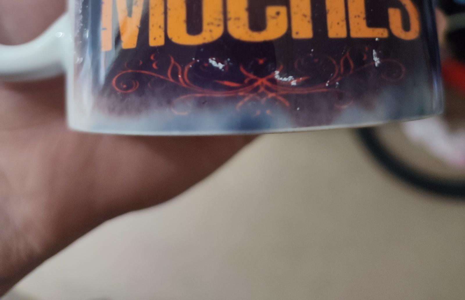

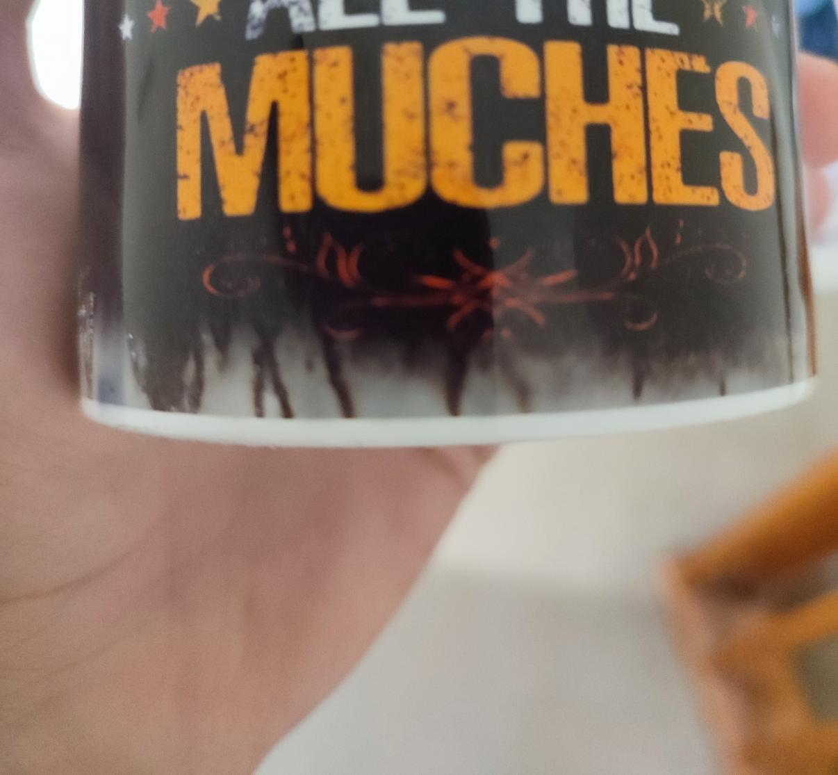

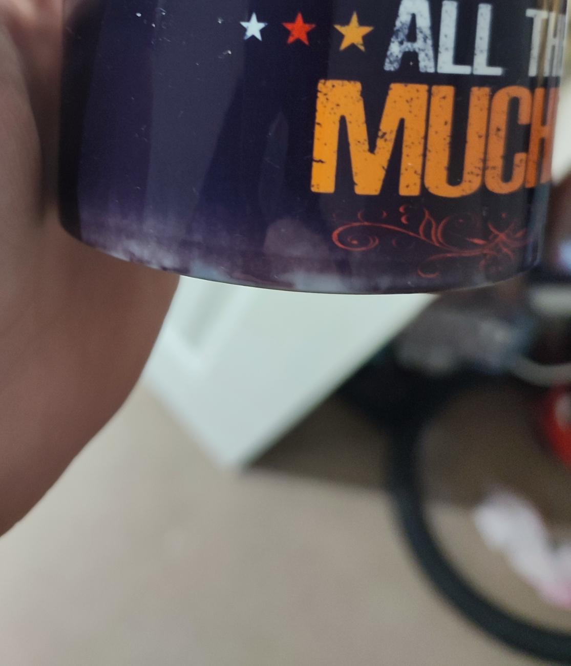

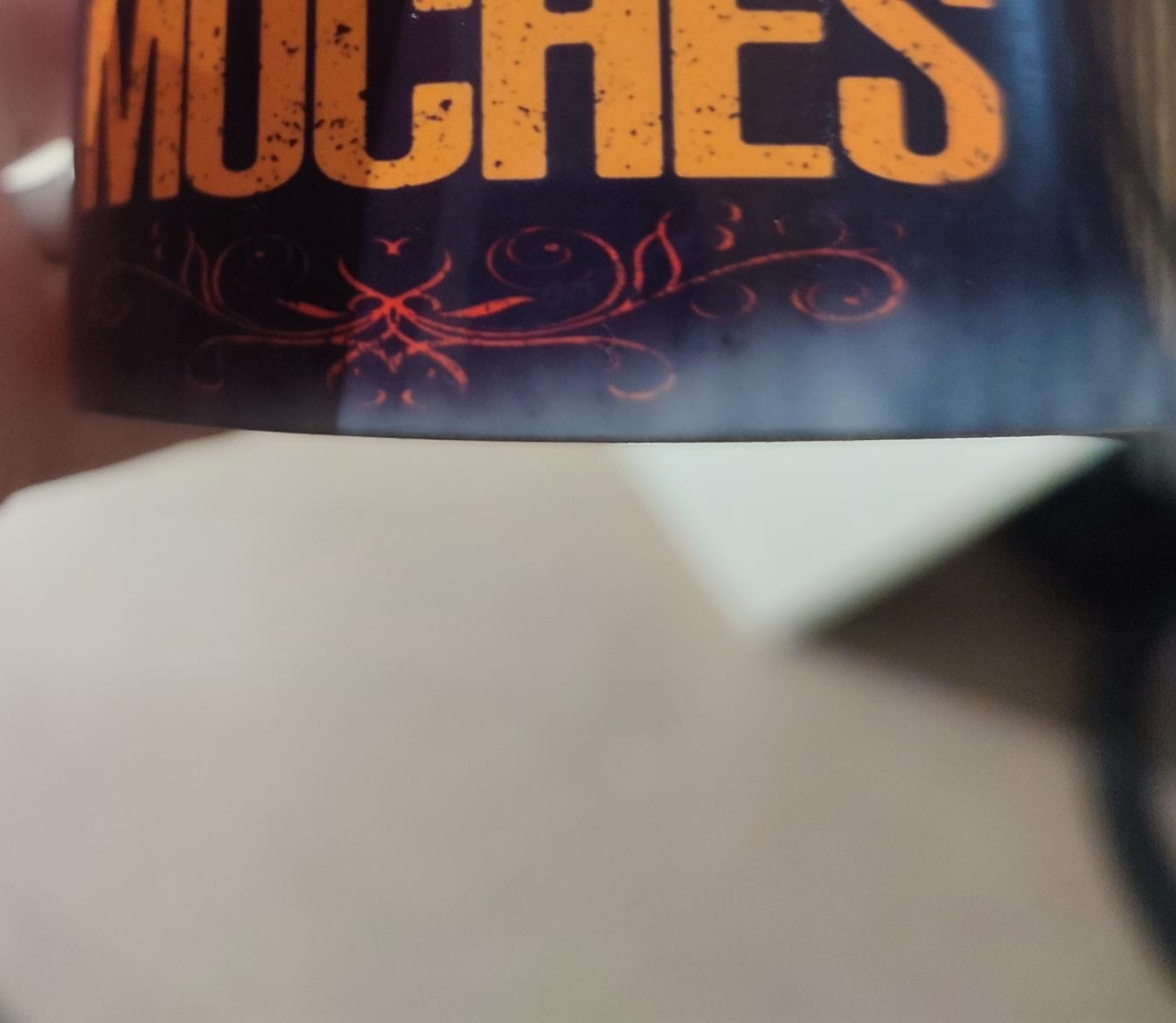

Hi Emily, please see below, this is just a handful of the ones that failed. I've done about 10 now all failing in the same place[ATTACH=CONFIG]7380[/ATTACH]
[ATTACH=CONFIG]7381[/ATTACH][ATTACH=CONFIG]7382[/ATTACH][ATTACH=CONFIG]7383[/ATTACH]

It doesn't look like a coating issue as the areas at the bottom are showing signs of under pressing. This is most likely due to lack of pressure at the base, maybe due to the mug sloping off slightly towards the base which is normal and why we never advise a top to bottom print to avoid this issue.
My advise would be playing with the pressure to see if the results improve. Heavier pressure I would try first to try and spread the pressure throughout the whole mug. Alternatively reduce the size of the artwork to leave a gap at the top and bottom of the print to avoid this issue.
If you are still having no luck then please give us a call and get a ticket raised with our technical team so they can investigate this further for you.
