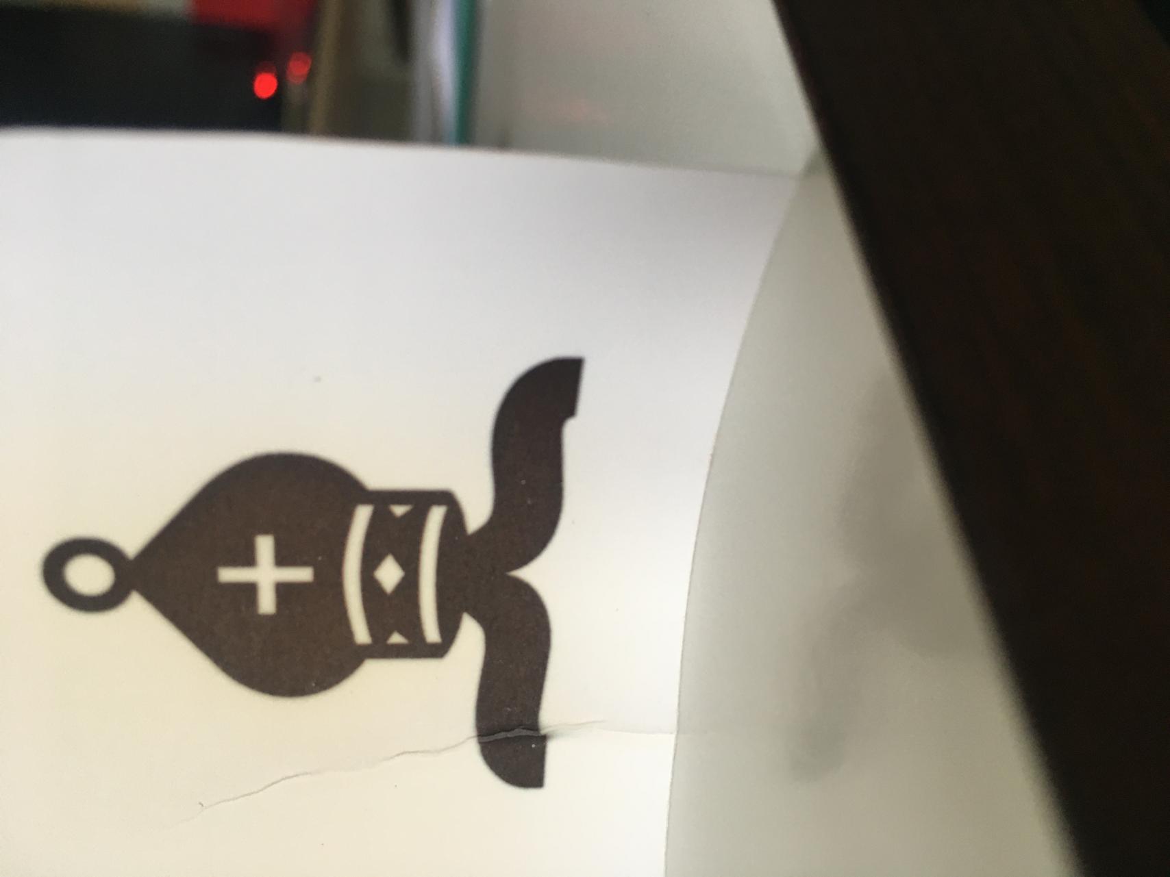

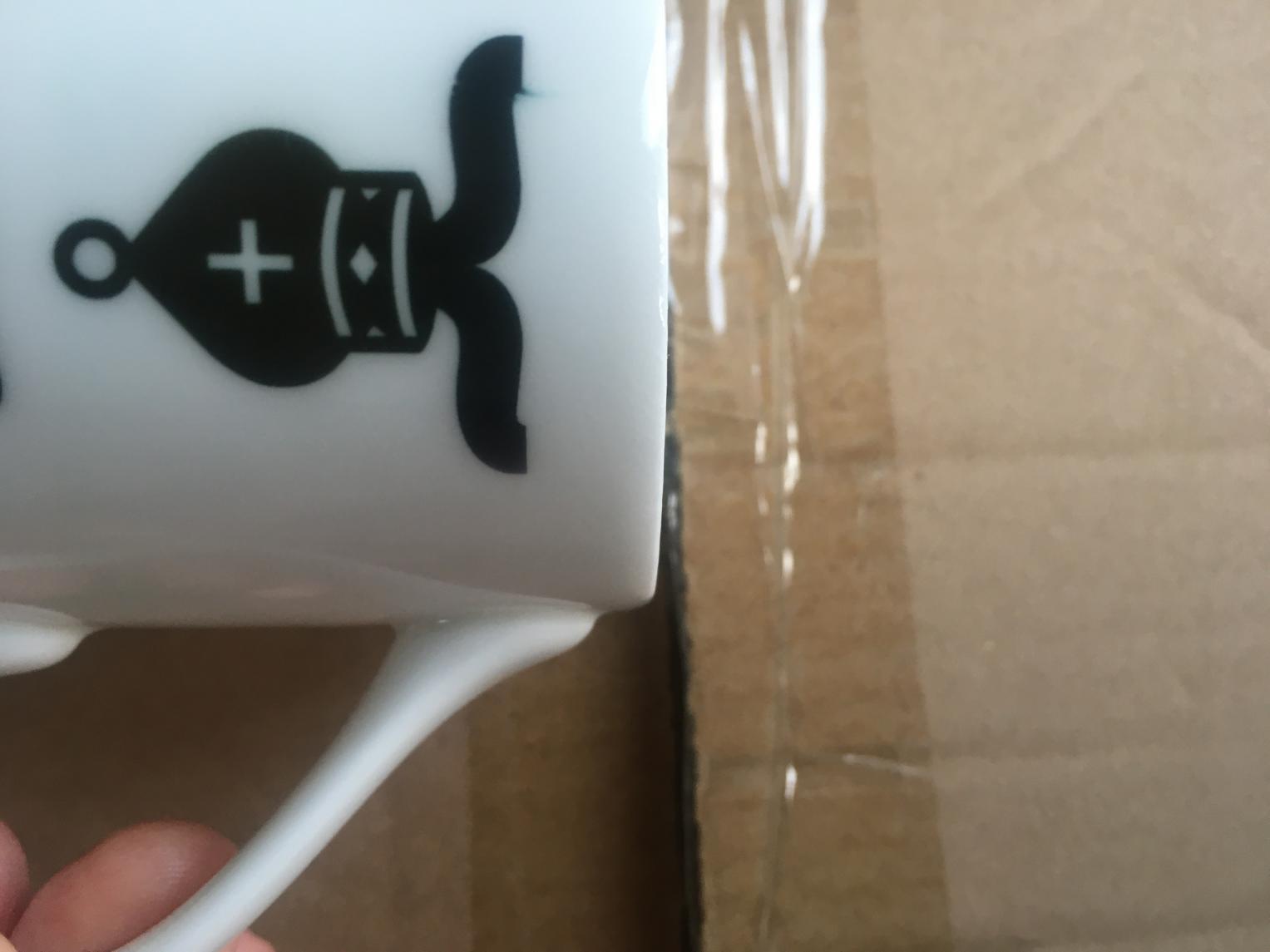

Every time a “Balmoral” mug is placed in my mug press creases are formed in the print paper extending up from the bottom of the mug by about 30mm. The sublimated ink can then travel along the crease and end up as a mark on the mug (see the attached pics). I eventually noticed that with the print tight to the mug at the top it was loose at the bottom. DSS describe the mugs as 75mm in diameter but I when I measured them with a micrometer I discovered they were typically 75mm at the bottom but 76.5mm at the top which equates to nearly 5mm difference in circumference. It appears that compressing that extra 5mm flat in the press is what is causing the creasing.

[ATTACH=CONFIG]7325[/ATTACH][ATTACH=CONFIG]7326[/ATTACH]
