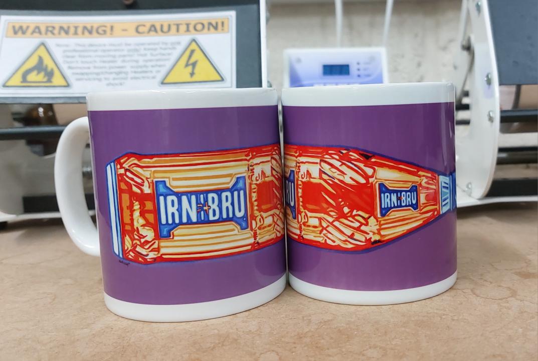

Is there any chance you can post up a mug printed using the new setup next to a mug printed on your old setup for comparison.

3210 on left and SG400 on right:
[ATTACH=CONFIG]7306[/ATTACH]
- vB_ID:7306
- mug compare.jpg (90.94 KiB) Viewed 12 times

It might be me but I can’t see any difference.UK Printed Mugs;153605 wrote:3210 on left and SG400 on right:

Yes that's the point. We needed to replace our aging SG400's (down to 2 from bank of 8) and nothing else has printed as perfect colour match until now. In fact the dithering is a little better on the mugs we have done so far.
