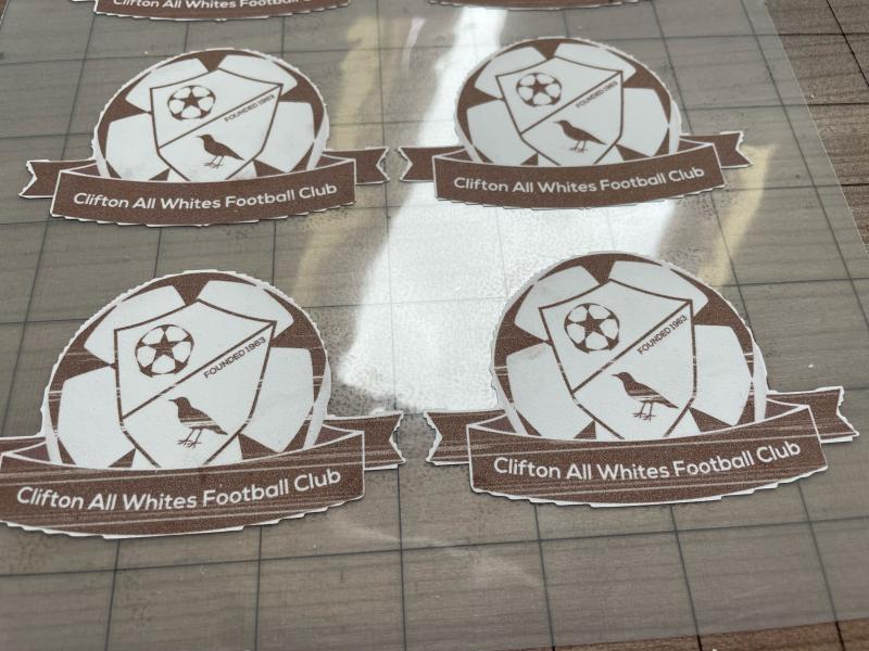

Hi all, I've just printed and cut my first run of [FONT=&quot]Easy Subli, it's not gone quite to plan though. As you can see from the image the cut has [/FONT]jagged edges and the first crests through the printer have lines through them.
I'm using a cameo Pro, Blade set to 3, Material is heat transfer flocked, Speed is set to 8 and force is 15.
My printer is an Epson ET-14000, the print and cut was sent from Silhouette Studio.
Suggestions as to why my first run has come out like this please?
Thanks,
Martyn

As the jagged edges are the same on all I would say it’s an image issue.
probably it’s had the white background removed but not properly most likely by automated software.
open it in ps and see if the edges are there on a transparent background.
make a black layer behind it to make it more visible.

Thanks for the response. There is a setting in the Silhouette software that you have to switch on. You need to have High pass off and low pass on, why you would want a jagged edge by default I have no idea.
