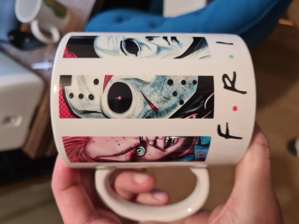

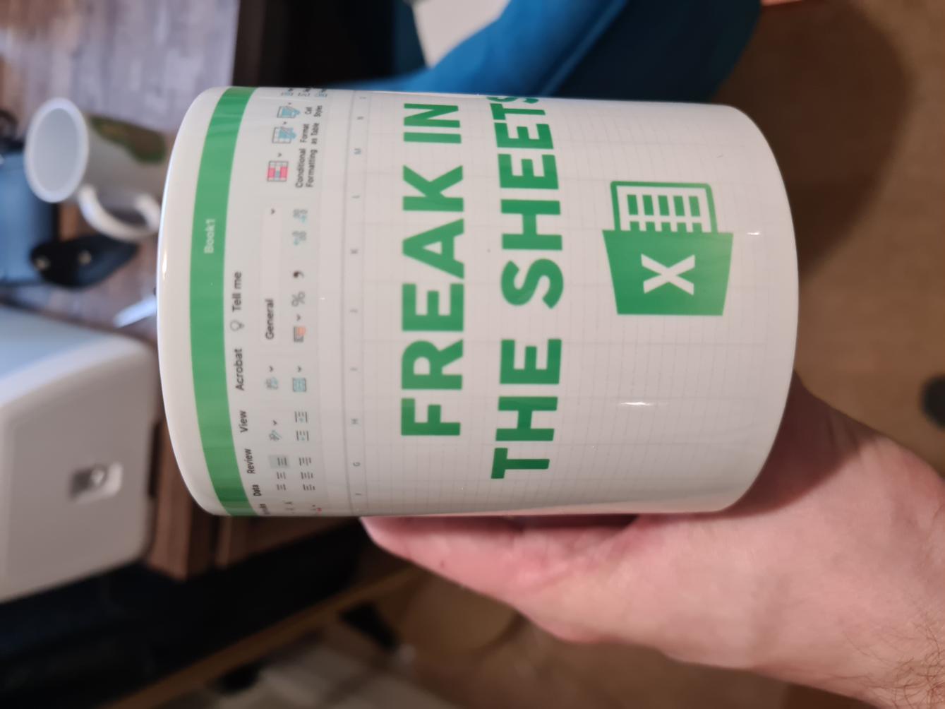

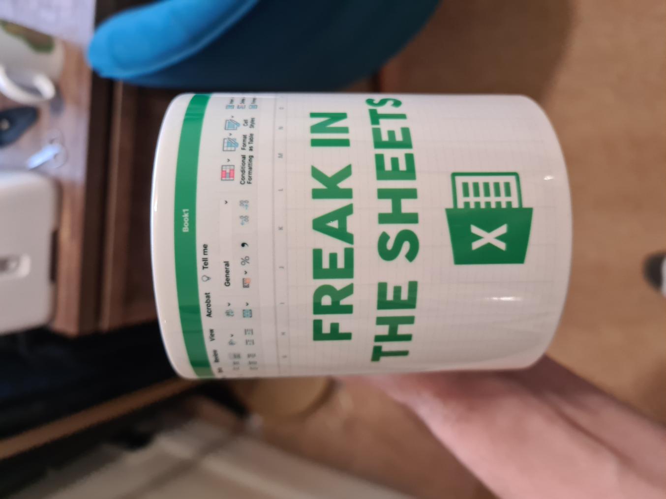

Here's photos of a typical mug at 360f for 145 seconds (the FRIENDS mug), the green mug at the same settings (faded at the top and bottom) and the green mug at 380f for 200 seconds.[ATTACH=CONFIG]7061[/ATTACH][ATTACH=CONFIG]7062[/ATTACH][ATTACH=CONFIG]7063[/ATTACH]

Are the mugs going into the press cold?
I would advise pre warming them to heat the bottom but it could also be the heating element there’s a few things to rule out first.
Is the press tight enough against the mug?
Have you got a different paper you could try?
