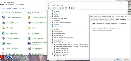

I had a similar issue with my printers cutting out every few seconds. Turns out it was a power management issue with the computer turning off the USB to save power.[ATTACH=CONFIG]6983[/ATTACH]
vB_ID:6983
vB_ID:6983
Screenshot (61).jpg (19.98 KiB) Viewed 2407 times
