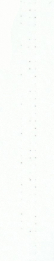

I'm getting small patches of vertical dots on my printouts using my Sawgrass SG400 printer using A-Sub sublimation paper (also tried Sawgrass TruePix Classic with the same results). Please see attached close up of the marks. They are about 2-3mm wide and seem to appear in the same spot on the paper and mainly after printing with black areas.

- vB_ID:6892
- dots.jpg (50.13 KiB) Viewed 152 times

I've done some more searching on this subject and the suspect now appears to be dirty/clogged pinwheels. Thing is, I've opened up the SG-400 printer but I can't seem to be able to see any pinwheels visible. Does the SG-400 have these, and if so are they accessible?
