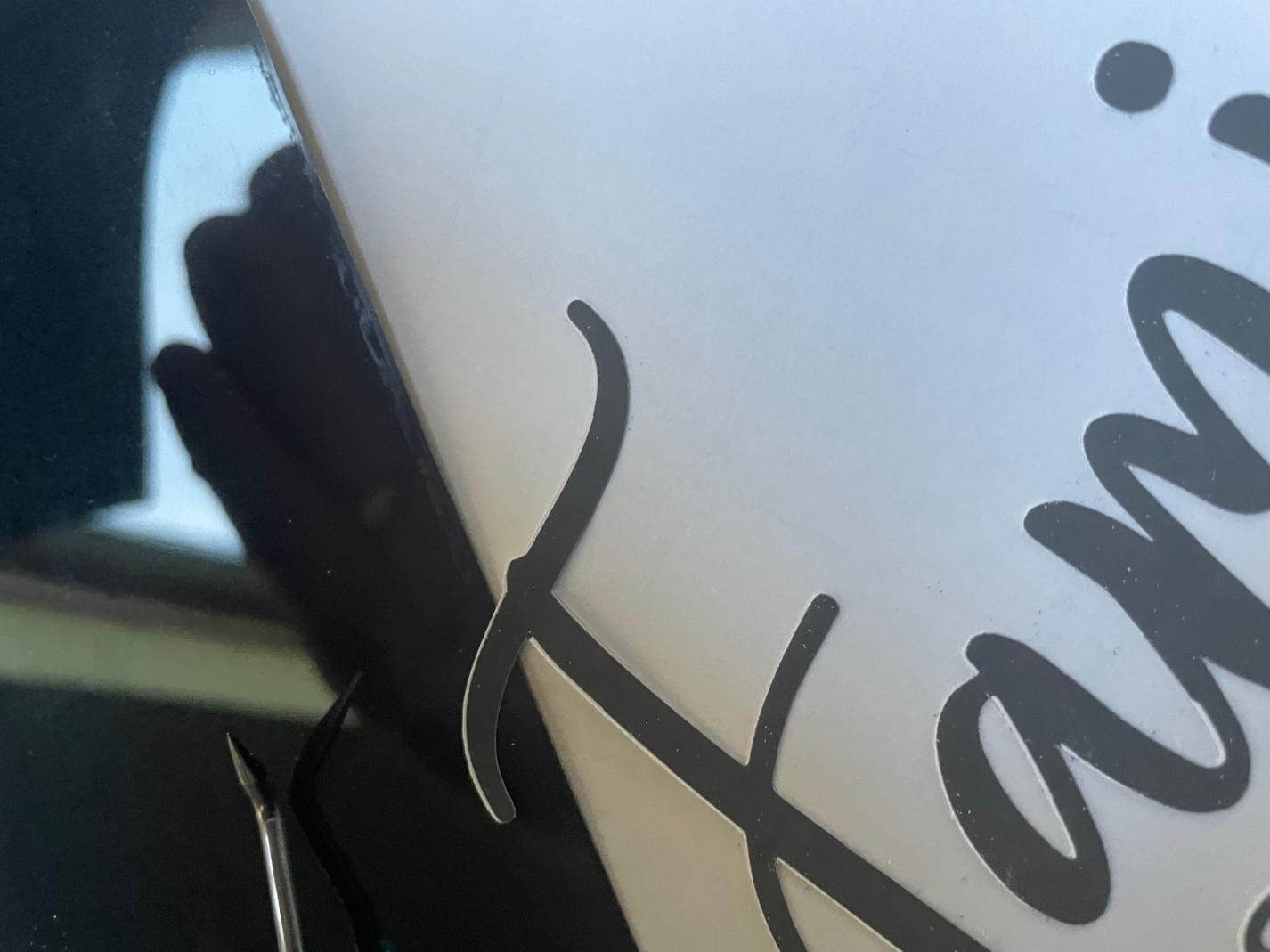

I have a small issue with my Cutter, after I've my design has been through the cutter and I've weeded, there is still a small white line around by design, its not quite cut all the white waste away.
Anybody any ideas and how to resolve it?

[ATTACH=CONFIG]6889[/ATTACH]

Re: Cameo 4 + Jet Opaque
alignment issue. add bleed for quick fix

Thanks for the quick response, where do I find this setting, had a quick look but unable to find it

Think I may have it, will give it a test now

If you can't work out how to add bleed then just drag a self coloured box around the text. Uses a bit more ink but less wasted media. (A contour line around the text will work as well, with a self coloured fill).

Worked a treat, thank you
