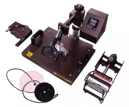

I have a combi-press (looks just like the one in the attached picture) but have a problem with the large A3 flat-bed. Everytime I switch the machine on with the flat-bed connected, it trips the RCD in the house! All the other attachments work fine (mug, plate etc).
I've taken the flat-bed apart and it only contains a couple of insulated wires, but one of them looks very black, kind of singed (?). I moved som of the fluffy insulation around the wires and it kinda worked, but the temperature was reading incorrectly - it melted all the pieces of a cardboard jigsaw together (not much point in a 1-piece jigsaw methinks!!)
So, my question - does anyone know where I can get a replacement flat-bed from, or know how to repair it properly? I'll speak to an electrician next week but not sure he'll know much about them.
The connection is the round connector with the 3-pins.
Thanks in advance...........
Barry

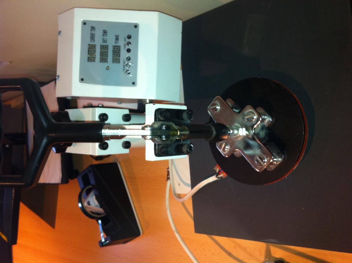

Hi Barry has it got a senko timer box ? if it has mine has gone the same way

I can't see any writing on the timer unit at all! I've attached a photo of it, but doubt whether anyone recognises it!

If your flat bed attachment is tripping the RCD, that is caused by an imbalance between the live and neutral wires, usually caused by one of the currents leaking to earth. Essentially the equipment is not safe to use in that condition.
Most platens will have four wires, the two heavier ones going to the heating element and the two smaller ones going to a heat sensor. Sensors are easy to replace, but if the heating element has gone, it is unlikely to be a cost effective repair.

Hi Dreamglass - it's exactly as you've described. So are the heat sensors inside the platen itself?

Yep the heat sensor is a small device at the end of the wires called a thermistor. It varies the resistance of the circuit depending on its ambient temperature, which is what gives feeback to the control circuits to maintain the temperature of the platen.
