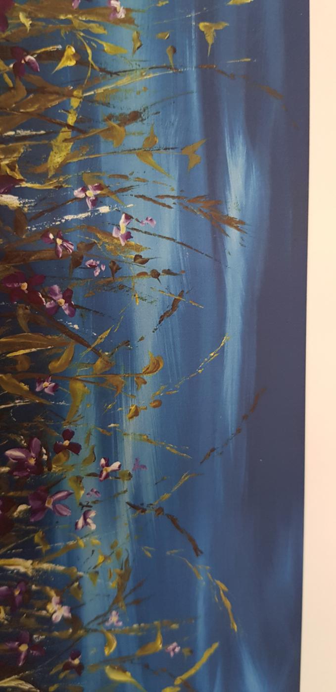

Banding on SG400 which is only 16 months old. Yes we have talked with Sawgrass but it seems they had a work experience kid on support. Banding only happened recently and we have cleaned everything from encoder wheel to capping station but no change.
[ATTACH=CONFIG]6623[/ATTACH]

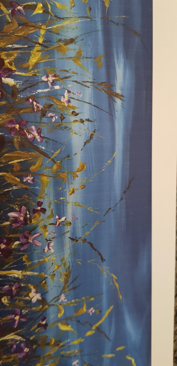

Interestingly we changed from paper type "inkjet plain paper" to "glossy" and the banding virtually disappeared (both unidirectional) although still faintly appears.
[ATTACH=CONFIG]6624[/ATTACH]

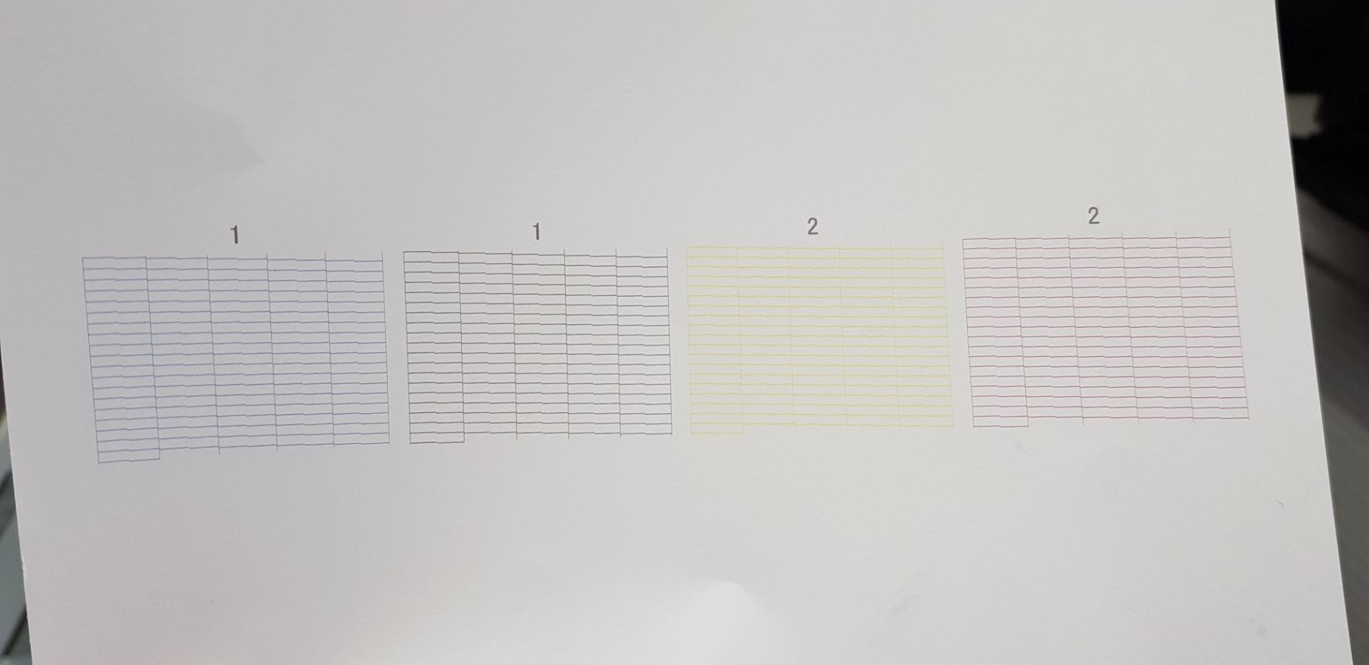

Nozzle check is 100% perfect yet the banding is only showing on colours using cyan.

When I first got my SG400 I had banding on Cyan, the nozzle check was fine on mine too. Sawgrass told me to keep printing full page bleeds (under the printer utilities section) I set this to cyan only and printed around 10 pages and could see the banding slowly improving and in the end this fixed the problem. Unfortunately it will use a lot of ink but luckily sawgrass sent me another cyan cartridge to compensate for it so they might do the same for you if it fixes the problem.
I have worked with dye sub for over 10 years now on a small scale and large format and have found if there are any issues with ink it is nearly almost cyan that causes the problem.
I hope this helps
