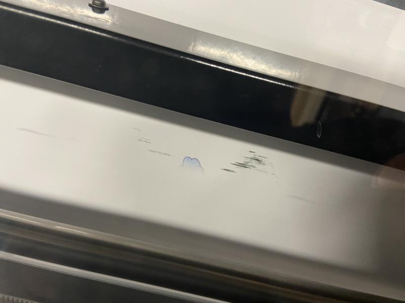

If I start a print job after loading the vinyl or after a day of non printing I get smudging on the first inch in the centre.
I have checked the printer under the vinyl and there’s no raised areas or lumps etc.
and if I pull a few inches of vinyl through so it overhangs it’s perfectly fine.
im assuming it must be vinyl curling causing the print head to rub on the vinyl?
Is there a way to cure this other than pulling the extra through every time I walk away for a period of time.
[ATTACH=CONFIG]6579[/ATTACH]
vB_ID:6579
vB_ID:6579
Re: Need a bit of advice with bn20
yes it is vinyl curling. On any roland video you will see that they recommend pulling at least 30cm. Is really winding me up as I could make £200 out of that piece :cool:

Paul;147409 wrote:yes it is vinyl curling. On any roland video you will see that they recommend pulling at least 30cm. Is really winding me up as I could make £200 out of that piece :cool:
Its gutting especially when it ruins a whole line of print and you have to start again.
