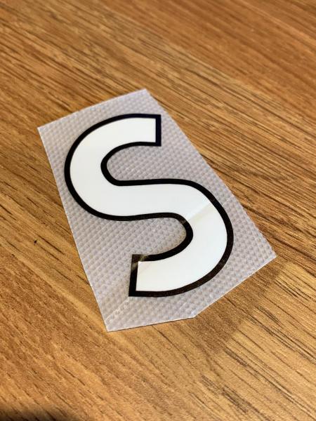

I am looking for some advise help. I am new to the vinyl world. I own a heatpress. a Cricut maker cutting machine and just got a sublimation printer.
I have a couple of projects i want to do. 1 being some hoodies using a single colour Vinyl which is fine. However my second project is causing me a lot of confusion on the best method to reproduce the prduct.
I have some font that i want to use for a local U16s team which has a primary colour which a coloured border (v similar to PL font)
i have the file for cricut design maker. but im confused on the processs
do i print font design onto sublimination paper then heat press onto the vinyl then cut? or do i just get HTV and use design maker to print and cut directly? however i struggled to find printable HTV that i can use sub ink to print onto . its all "paper" that uses normal inkjet and feel cheaper.
i have attached some photo of the example of the font.

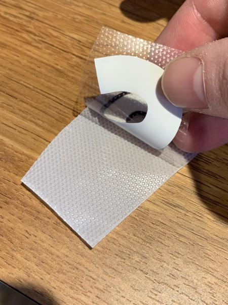

Note when i peel it up the underside is sticky
any advise on the process to reproduce these would be appreciated

If the underside is sticky then it sounds as though you have used SIGN VINYL and not HTV.have attached some photo of the example of the font.

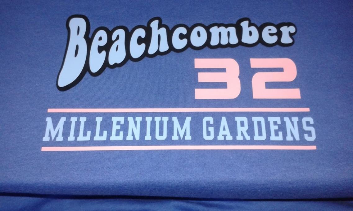

To achieve the reult you want using HTV you can layer the white on top of the black+outlne, or you can cut the black outline only and position the white inside it.
Personally, to avoid misalignment due to stretching of the fabric, I would use the first method ...
1, Cut the black+outline.
2. Cut the white (no outline).
3. Tack the black onto the fabric by pressing for about 5 seconds.
4. Overlay the white on the black and press or the full recommended time.

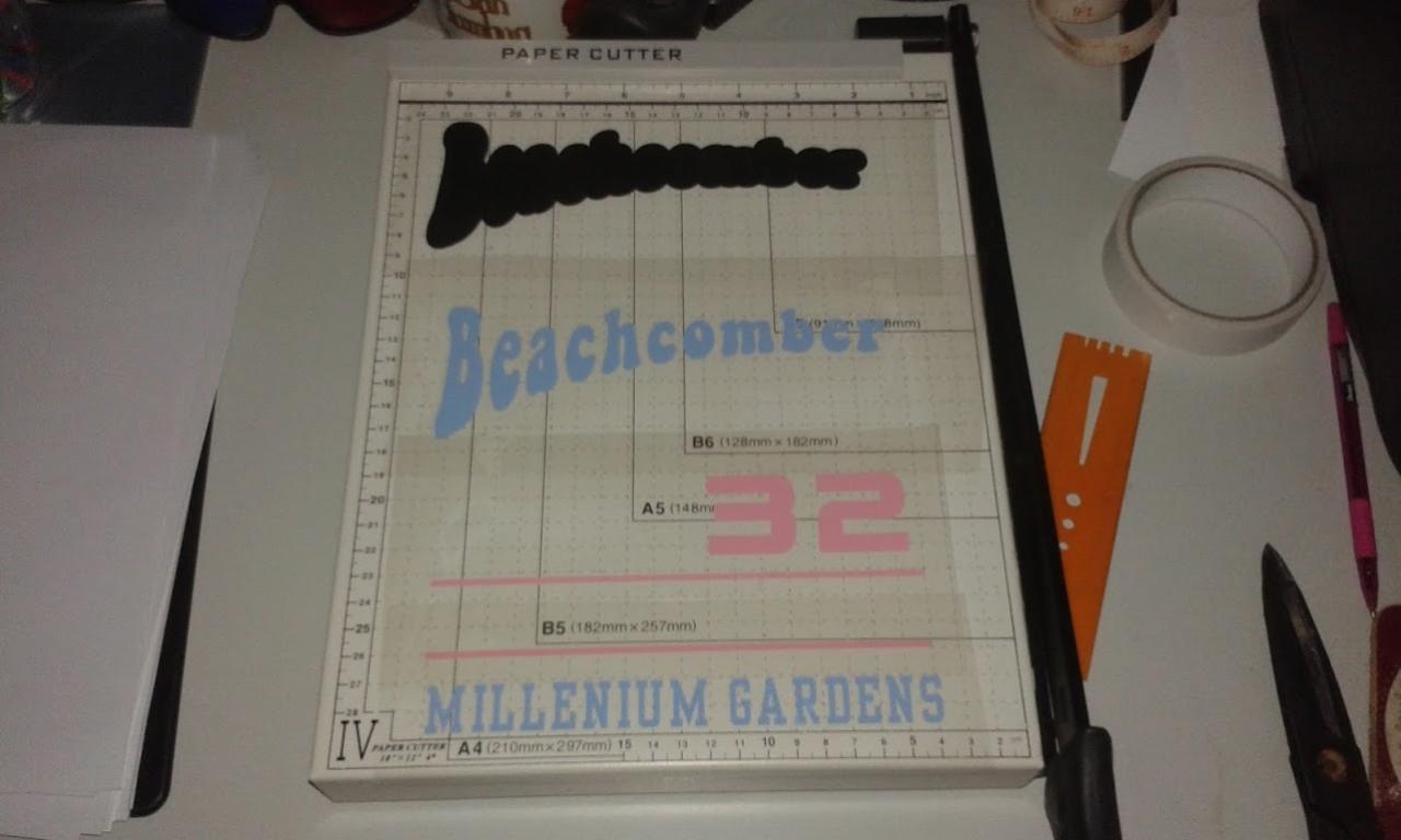

Here's a tester I did a while ago. The light-blue 'Beachcomber' text is one layer on top of another black one. After pressing, the hand still feels very soft and flexible and adherence is good. (I used HotFlex vinyl from MDP).
[ATTACH=CONFIG]6577[/ATTACH]
Here are the cut pieces before pressing.
[ATTACH=CONFIG]6578[/ATTACH]

To achivee the reult you want using HTV you can layer the white on top of the black+outlne, or you can cut the black outline only and position the white inside it.
Here's a tester I did a while ago. The 'Beachcomber' text is one layer on top of another. After pressingthe hand still feels very soft and flexible and adherence is good. (I used HotFlex vinyl from MDP).
