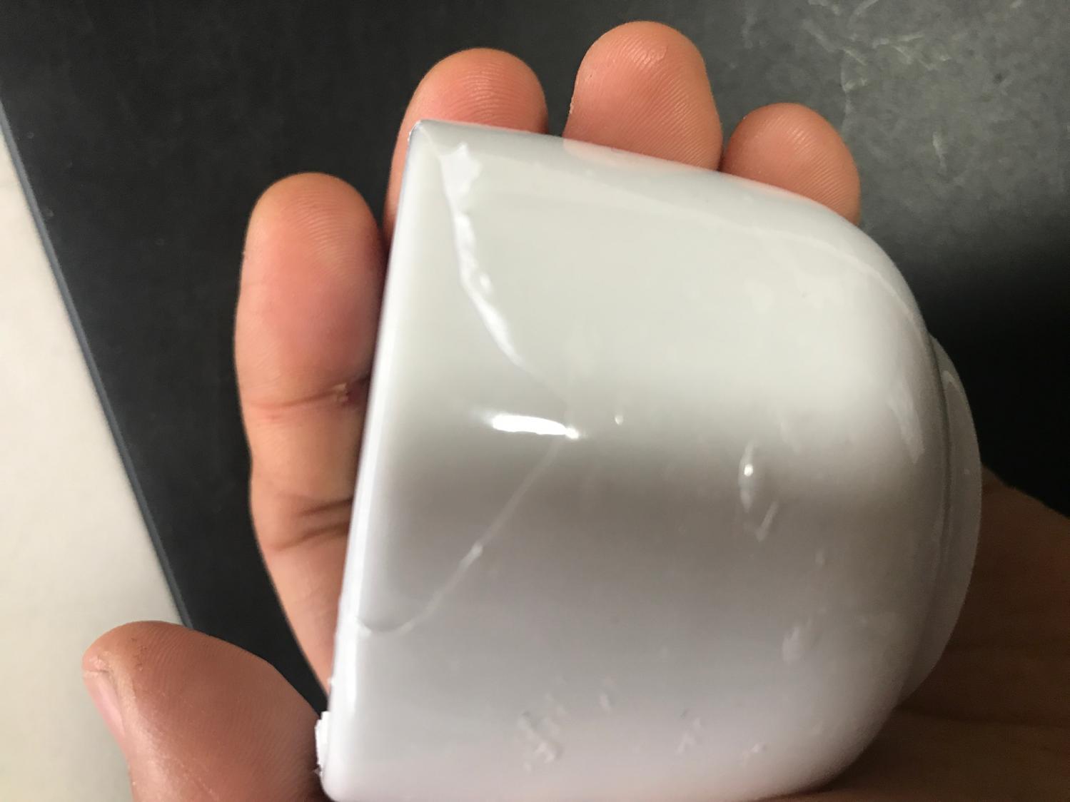

At first, I poly-coated my ceramic planters, and cured in oven, and attached sublimation paper with a tape and wrap, apply heat by using heat gun, and put it in oven.
I tested various time and temp in oven.
And I found that If I put it in oven 400F for 8 mins, it prints good. However shrink wrap attach to planter, and it is not easy to peel off. [plz check attached picture 4519]
Less than 8mins, it is easy to peel off. However it didn't print good.
Can you let me know if there is a way that I can avoid the issue?

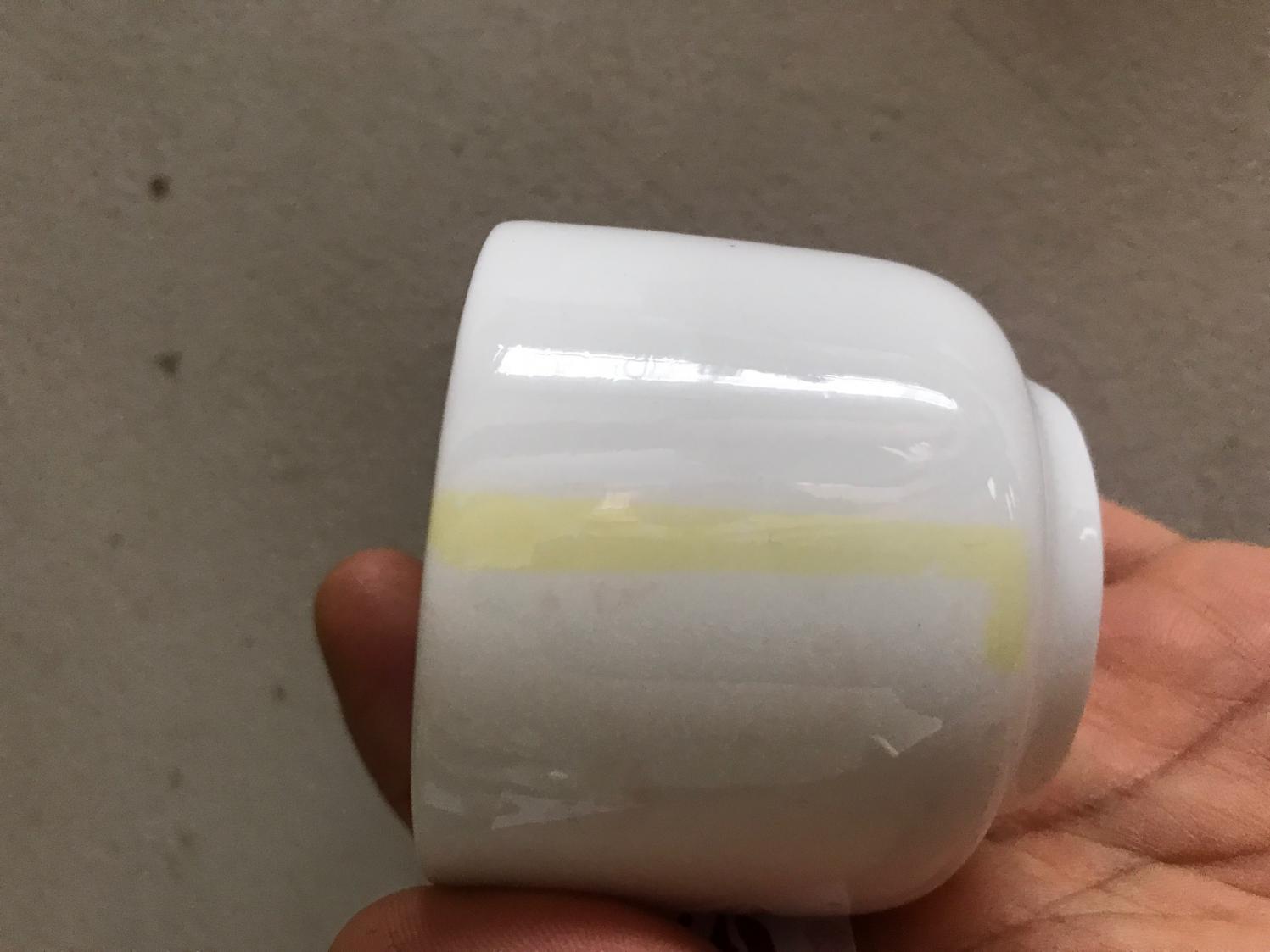

Another problem that I found is that high temp tape left a yellow trace on the planter[Please check attached picture 4520]
I found it is caused from the the poly-coating.
I purchased the coating from Amazon : https://www.amazon.com/Dyepress-PolyGlo ... 522&sr=8-8
Can you let me know how can I use the tape without leaving the yellow trace on planter?
I didn't use other poly coating yet. Does other poly coating make same issue?

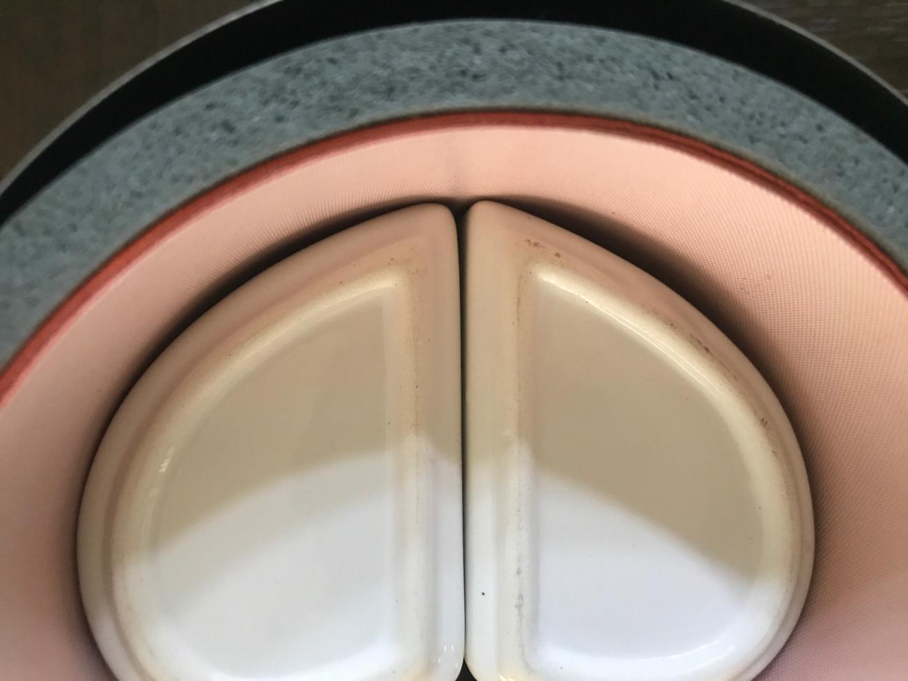

Because I had those issue with silicone wrap/shrink wrap and oven, I purchased mug presser.
However I found that there is a gap between my planters and the pad like attached picture [4517]
Can I put some thin fabric or substance in the gap to transfer heat all over the planter?
Is there a technic or tip that I can use in the case?
