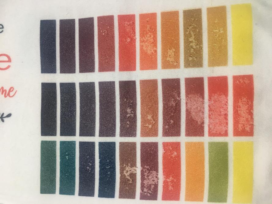

I am new to dye sublimation although i have done quite a bit of research i need some help with a problem i am facing.
i am aware that usually you cannot sublimate onto cotton products however you may of heard of "Forever" products which now offer a 100% cotton transfer paper.
The drawback of this media is that you have to use full tone colours and its not really suitable for photos, which is fine for what i need it for. "Forever's" website has a test colour chart which can be printed and transfered to check colours are correct and transfering.
As you can see from the picture below some of the colours are not transfering properly, i have tried different pressures, times and temperatures but i can't get a consistant result. The picture below is probably the best i have had.
From your experience what could i be doing wrong? Only thing i can think is that the press is not heating evenly.
Thanks.

I am very familiar with Forever papers but in order to answer your question I need to know the following:
What printer
What Heat Press
What Time
What Temp
What Forever Paper
If you can let me know the above I might be able to help.

I am using a Epson L3111 printer, which is brand new.
The heat press has no brand on, it was an eBay job which has been fine for the vinyl pressings that we currently produce but thinking maybe it may not be heating evenly for sublimation?
i have tried different times but the best results were pressed for 25 seconds at 160.
Also tried different pressures but can’t seem to get
anything consistent.
the paper is Subli-light (no cut)

Re: Transfering problems
I think your problem will be the heat press.
New transfer papers are heavily reliant on very good heat presses (Aadkins, Geo, Stahls etc). The pressure has to be even and the temperature must be consistent across the platen. You do not get that reliability on the cheaper unbranded heat presses you find on the likes of Ebay.
I know a few people who are using this paper and are having fantastic results, but I know that all of them are using very good presses.
try pre-pressing the material and see if that works, while above some cheap heatpresses are not as good that is not true for all of them at all, sometimes its just pot luck if its ok or not. i have a heatpress off ebay a swing away one and it a handy one where the base slides out giving more room to put on and take off products and its not perfect build wise but ive had zero issues that are caused by the heatpress....my current issue i think is the product i am sublimation or the paper
