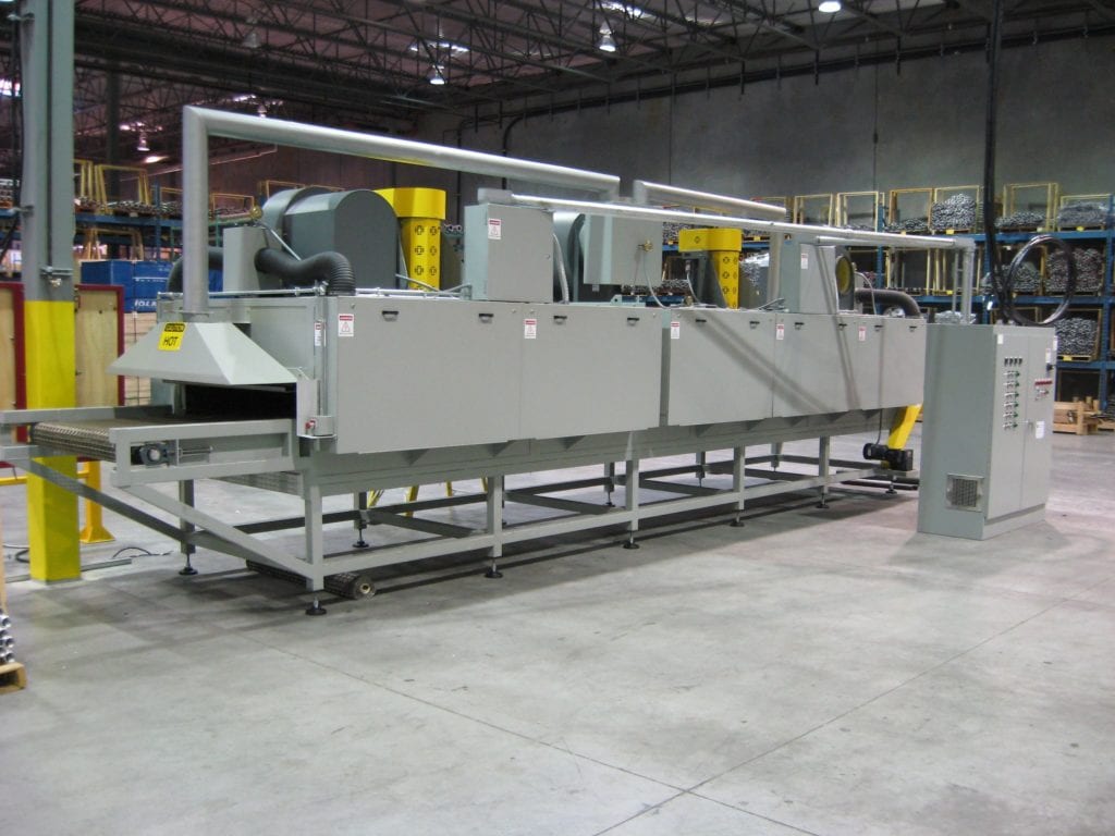

Re: Ghosting with Oven
This one look like a toy compared to the our one. But I am sure it will speed up the process any way.socialgiraffe;146800 wrote:Seriously tempted, particularly as the price has been slashed...
https://adexa.co.uk/Commercial-Conveyor ... u4QAvD_BwE
Our was similar to this
[ATTACH=CONFIG]6486[/ATTACH]
100s per hour.
