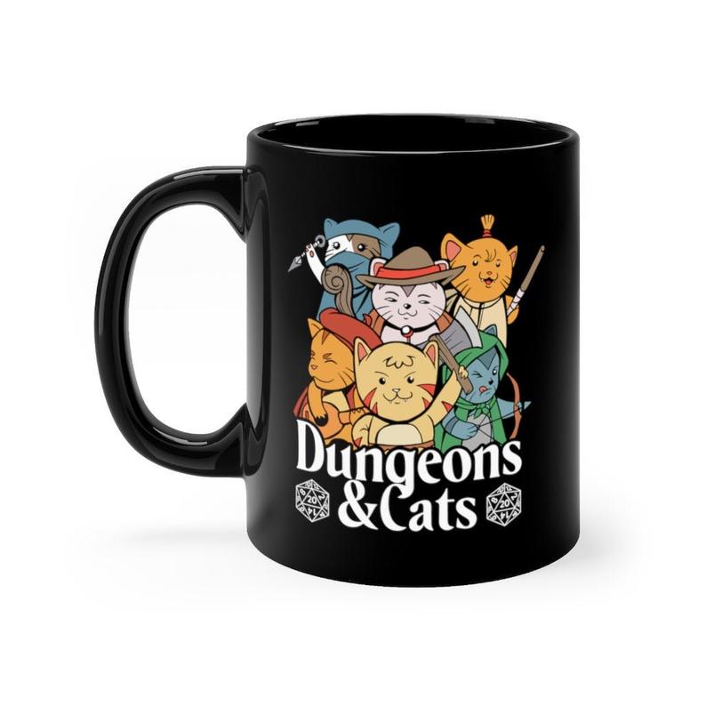

Does anybody know how these are made?
I know you can get the black mugs with white strips and then you sublimate onto them but these look a lot cleaner.
[ATTACH=CONFIG]6439[/ATTACH]

There are several different ways that black mugs are printed, but reading "between the lines" Mrteajunkie is correct in what he suggests.
Other options are cylindrical screen printing, tampo printing and waterslide technology but these three methods require a lot of specialist knowledge and kit.
White toner printing has come a very long way and as someone who uses theirs A LOT the results are spot on. At the moment the process is quite expensive as the mugs alone are £1.80 plus VAT, however in the New Year I am hoping to be able print on any colour mug (no coating required) with it being dishwasher proof etc.

Which paper are you using? TMT or Forever?socialgiraffe;145843 wrote:There are several different ways that black mugs are printed, but reading "between the lines" Mrteajunkie is correct in what he suggests.

TMT EarlWhich paper are you using? TMT or Forever?
Get superb results with it.

So is this more like a vinyl than sublimation?socialgiraffe;145843 wrote:There are several different ways that black mugs are printed, but reading "between the lines" Mrteajunkie is correct in what he suggests.
Re: Black Mug Printing?
No, it’s just a different style of printing, vinyl printing on to mugs is considered a bit Mickey Mouse

Magic touch CPM paper - works on ANY mug, ....
BUT - will scratch off = it isn't very durable
Its quite durable, but deffo not dishwasher or scour resitanat...

It’s not the print that scratches it is the mug coating itself (if you get the best mugs for the job in hand)logobear;146653 wrote:Magic touch CPM paper - works on ANY mug, ....
However, this is all about to change...
