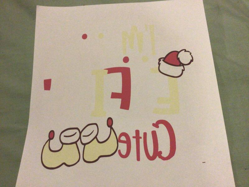

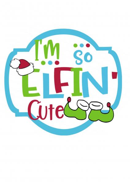

I am trying to print [ATTACH=CONFIG]6419[/ATTACH]this image but the blue and green aren’t coming out. I have just put in new inks and ran maintenance and everything is fine but when I print the above this is all I get
[ATTACH=CONFIG]6420[/ATTACH]
I have gone over the colours again, tried different shades of blue and green but always the same.

Re: Colour issues
Definitely looks like there's no cyan in the printout. Can you do a nozzle check and show us the result?

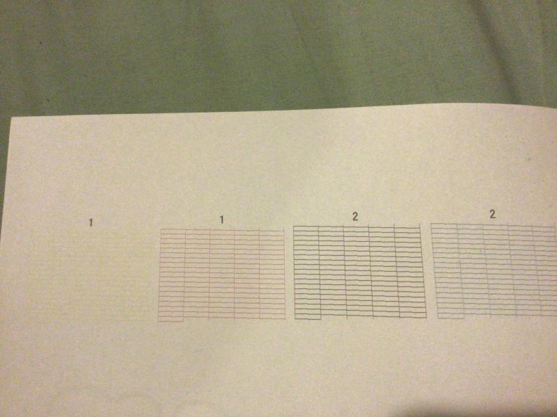

[ATTACH=CONFIG]6421[/ATTACH]
this is nozzle check printout

Re: Colour issues
Thank you.
Well, seeing as the nozzle check looks ok then that kind of narrows things down a bit.
If the image displays ok on your computer then maybe try printing a different image. If that's ok then the problem is with the image. If another image still prints wrong then you may have to reinstall your printer drivers.
