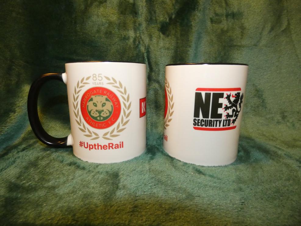

Morning everyone after several months I'll I have fully recovered and ready to go. Printed my 1st ever mug yesterday after sorting issues with printer. I had some sample mugs from listawood. My main customers will be sports clubs and I wondering about is it worth saving a little money on the price or not. Is there much difference between A and AAA. Think I'm going to order from Listawood but some people say xpres and Signzworld good. Any comments would be much appreciated. Hopefully I managed to upload my 1st mug picture.
