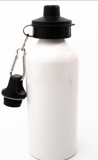

Hi can anyone tell me the correct temperature time and pressure for the aluminium White drink bottles [ATTACH=CONFIG]6352[/ATTACH]thanks

The timings vary depending where you get them from, are best used as a rough guide as the results will vary depending on the press used as well as the ink/paper used.
I generally go for around 10ish mins at 180-190c in the halogen using wraps although there's some other timings below.
Listawood:
170c for 45s using Genie III (160c idle)
200c for 45-60s (190c idle) using Genie I/II and Freesub duo press
200c for 300-360s in an oven
Subliblanks:
180-185c for 120-140s
Transfer Press:
190-200c for around 15mins in halogen oven
