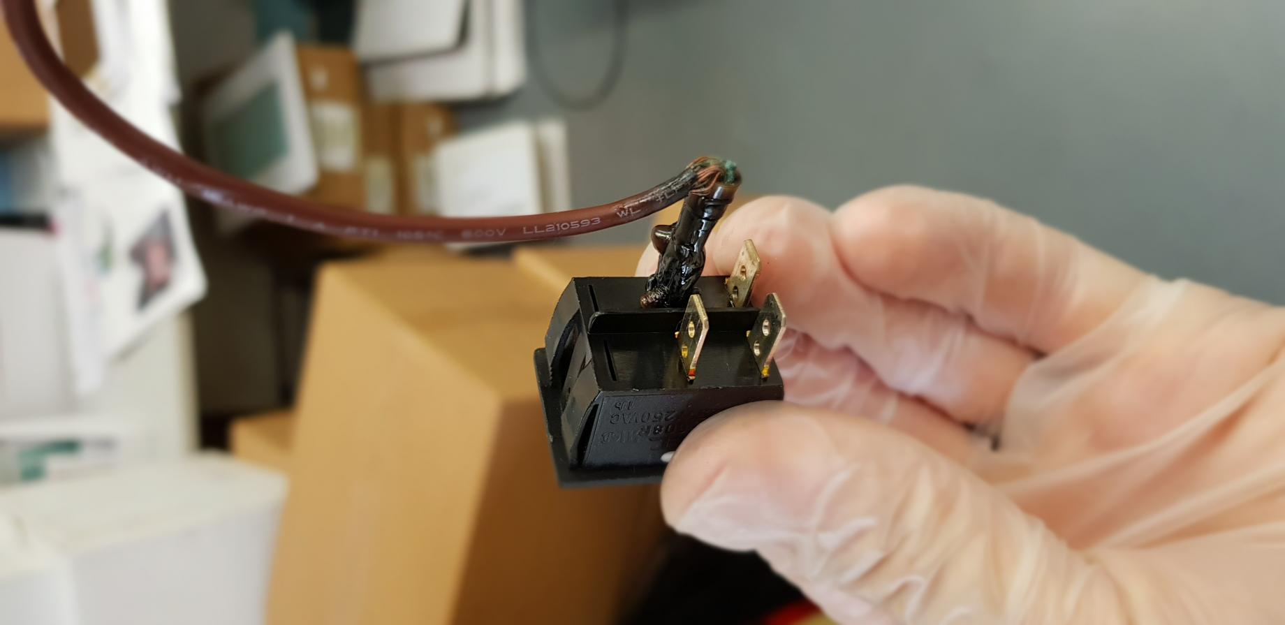

Brilliant. Got the new switch and fuse pack and just rocker switch and cables needed changing and back up and running. Quite worrying that it looks like switch started to melt Eek.

Re: Problem -Adkins Press Green Power Light
Yep that's why I suggested you stop using it because when they go it does look somewhat dangerous!
With the kit you get it back up and running much quicker (and cheaper) than sending it off
Loving the Covid 19 protection gloves there too :biggrin:
Yes I can't believe how dangerous it could of been especially as I have staff here using it all day. Thankfully fixed now and gloves thrown away quick
That must be a design flaw.
that would suggest there’s too much current running through that switch.
That can’t be safe.
