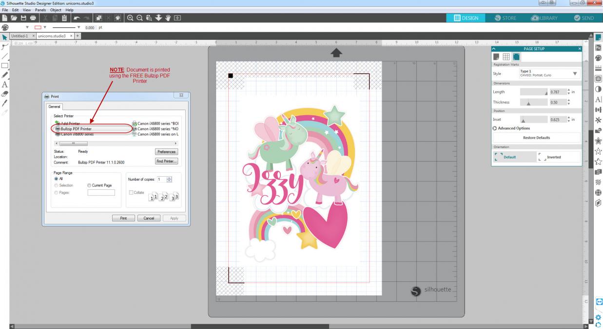

Ok. Thought I'd spend a little time on this.
I have Silhouette Studio Designer Edition (SSDE) that I haven't used in a long time as I never use my Cameo now. However, I can outline the process for saving as a PDF and printing with Photoshop.
1. Make sure your design displays registration marks then PRINT (don't SAVE) to a PDF printer driver. I use the free Bullzip driver. This will create a PDF document instead of a physical printout.
[ATTACH=CONFIG]6051[/ATTACH]

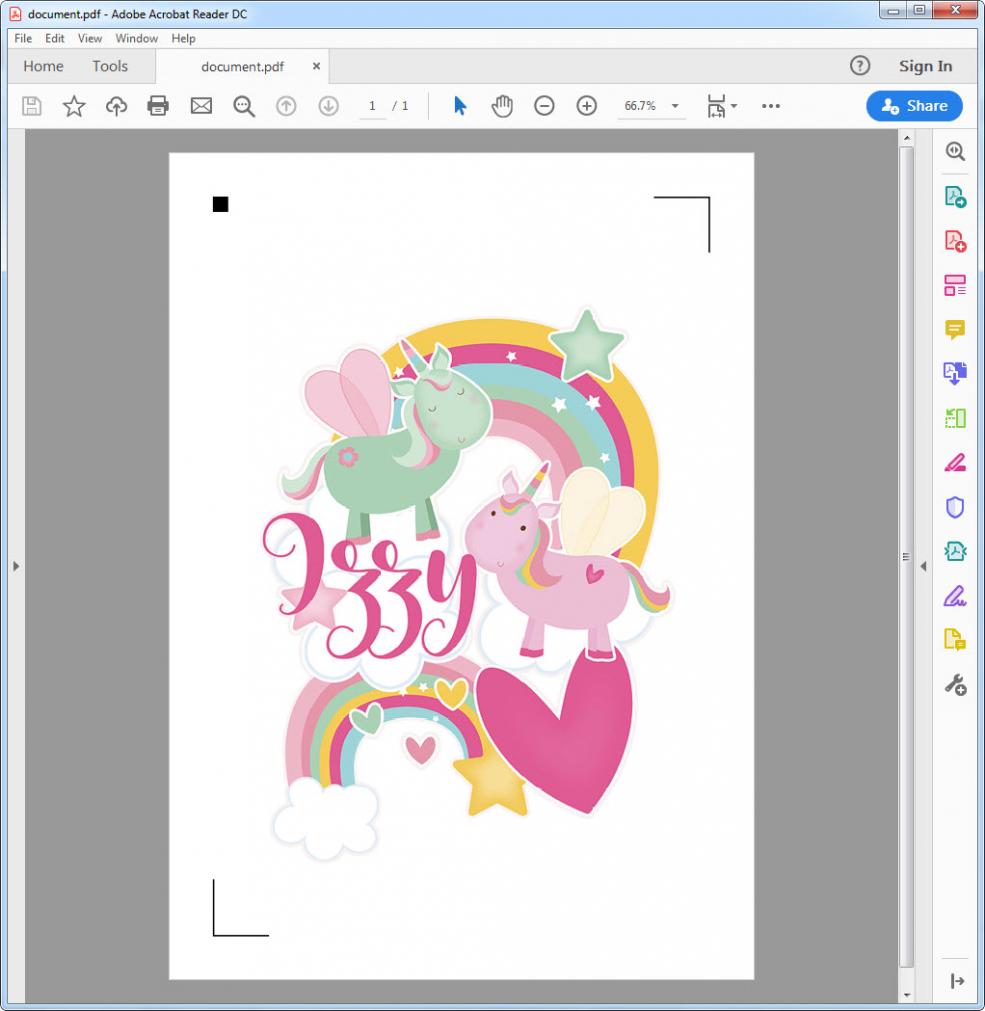

2. Bullzip will create the following PDF document (shown in Acrobat Reader) ...
[ATTACH=CONFIG]6052[/ATTACH]

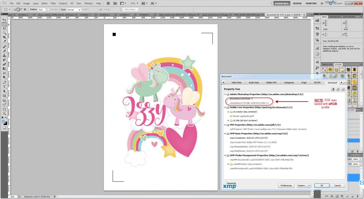

3. Open the PDF in Photoshop and you will see it has an sRGB profile. You can now print out the Photoshop document on your sublimation printer with your printer's ICC profile. You will now have a sublimation print with registration marks to be returned back to your Cameo for cutting.
[ATTACH=CONFIG]6053[/ATTACH]
[ATTENTION!] This was a quick lashup to show you the process. In reality, you would have to FLIP the image horizontally in SSDE so you had a mirror image for applying to your garment. IT'S NO GOOD flipping it in Photoshop as this would also flip the reg marks! Take care!
Hope this helps you out. Contrary to popular belief, you CAN produce PDF's from SSDE and most other cutting software using this method.
