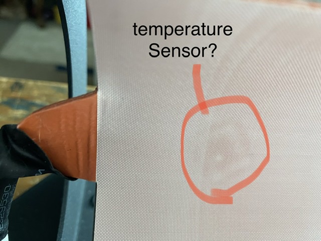

i have been in constant contact with one of their reps the list of issues is numerous. I have asked 2 times if the diamond shape I see in the cuff (about one inch in from the the power connector goes to the cuff on the right hand side is a temperature sensor and she replies with “the heating element is throughout the cuff” or another response about the heating element. I’m not asking about that I’m asking where the temperature sensor is because some sensor someplace I'm the cuff has to be reading the temp of the mug to know if it has hit the set point of the temp or not.GermanDyeSub;141835 wrote:Sounds like a defect from what you describe, and it's not pleasant. You need and deserve consistency. They have been active for 30 years and if they're reputable they should get it sorted for you. Report the issue to them. I assume that you are based in the US, am I right?
do you happen to know is this the temp sensor ?[ATTACH=CONFIG]6048[/ATTACH]

Let me also ask this do you find it matters which way you load the mug into the press? For example do you load the top of the mug facing towards the where the cables come into the cuff (right on my machine) or do you load the bottom that way ? Or does it not matter ?
Re: Mug Press and Issues
I can only tell you the Infos i have for the Genie3 press and in that press you should place the botton of the mug always to the right. So maybe you can check how the genie3 is constructed and compare it with your press. I checked it for you real quick and the genie 3 press has the cable connected to the heating element on the right side, so guess that is the position of the sensor as well. Maybe other presses have the cable attached to the left side of the heating element, who knows. This means the mug press gets the temperature from the mug bottom instead of the top which makes senseSDT;141995 wrote:Let me also ask this do you find it matters which way you load the mug into the press? For example do you load the top of the mug facing towards the where the cables come into the cuff (right on my machine) or do you load the bottom that way ? Or does it not matter ?
Now i wonder where my press has the connector, it will arrive on thursday. The thing is that my press has a supporting element for the mug bottom on the right side, so i hope the designers of this press thought about sensor problem as well :biggrin:
