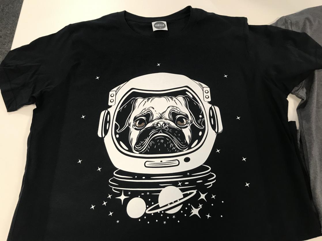

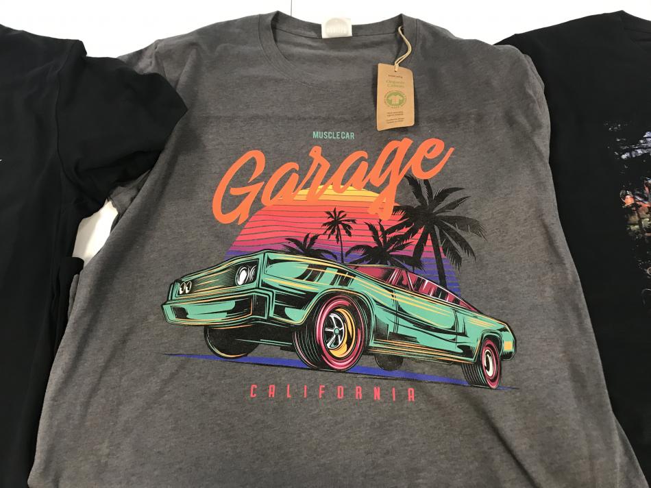

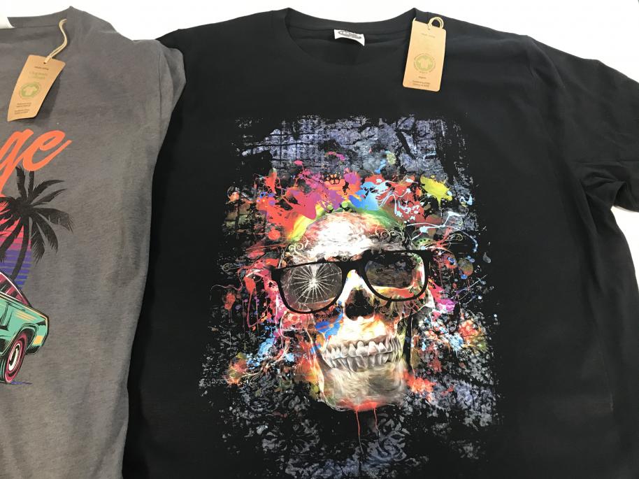

Attached are a few prints that I produced this morning for our display at P&P.

For the prints pictured I used the following equipment:
Schulze pre treatmaker VI
Sefa rotex swing press (curing of the pre treat)
Epson F2100 to print
Sefa T dry Drying cabinet (to cure the ink)
https://www.xpres.co.uk/p-9977-sefa-t-d ... 0-dtg.aspx
does the pretreatment always have to be that large surface area?
No, you can just pre treat the area you are printing
Cost of above and ongoing costs?
The prints pictured range from £1.30 to £1.58 in ink costs
Pre treat works out around 7p per spray I sprayed the shirts twice.
Ongoing the machine requires a Head cleaning set £63.48, this should last around 500-600 prints depending on how many cleans the machine has done
Maintenance of Epson, I know it has it's own cleaning cartridge but what are the 'hidden' if any costs and time involvement, maintenance routines etc?
The cleaning cartridge should last around 90 days, again depending on how many cleans are done
The Epson takes care of its own maintenance, we have two units in our showroom that are only used for demos and can sit for a week with use. We have not had any issues.
They do like being used and the more you use them the less they will auto clean.
Unlike the older Epson F2000 the Epson F2100 no longer dumps large volumes of ink. This is due to the closed loop white ink circulation system on thew new F2100.
Heatpress, auto and does it require a DTG platen, costs involved?
I used a standard heat press platen on the Sefa, you can purchase a DTG platen that will help the steam that is generated in the drying process escape.
DTG printing is not just about the printer, good results on any DTG printer requires getting a number of processes correct:
Choice of T-shirt
Pre-treatment
Curing pre-treatment solution
If one of the above processes is not correct the quality will be affected. Investing in the other processes is just as important as the printer itself.
Choice of T-shirt
The T-shirt that you are printing on makes a massive difference. Order samples from a number of different suppliers, don't just buy on price.
Pre-treatment
Its is key to have an even coating of pretreat solution when printing with white ink this is the base that the ink is going to stick to, get this wrong and the printer has not got a chance.
Mix enough solution for a weeks work, if the solution sits with out being used it will start to congeal. This will then start to block nozzles in your pre treatment machine giving an uneven spray.
Again a very important stage, Make sure you apply heavy pressure so you flatten the fibres on the shirt this give the printer a nice flat area to print on.
When curing pre-treat solution you are putting the element on your heat press under a lot of stress, cheaper presses struggle to maintain heat so you will have to cure for longer.
Make sure the T-shirt is completely dry before printing.
I hope this helps.
