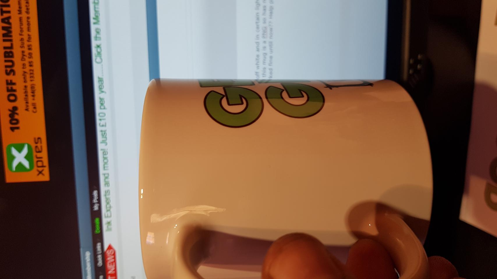

I've just printed some text onto some white 11oz mugs, the text has come out great but the background has come out ever so slightly off white and in certain lights you can see exactly where the paper was attached to the mug. In another post in the printing issues section my printer was actually printing a very faint background but this issue is now sorted (I think) and the image I printed for this mug is a PNG so has no background. I'm using an ST210 press, Sublinova ink and Ink Experts Paper which I've got to say I've never had a problem with. Press is preheated to 125, mug is put in and heated to 170 for 170 secs. These settings have worked fine until now?? Help please!

I'm having difficulty determining your issue from that image Rich. The whole mug has a yellow cast to me!
The best way to check if your image has a faint background colour is to view it in Photoshop (other graphics software is available!) and roll the mouse over the background to see if the RGB values change to anything other than 255, 255, 255 in the Info panel.

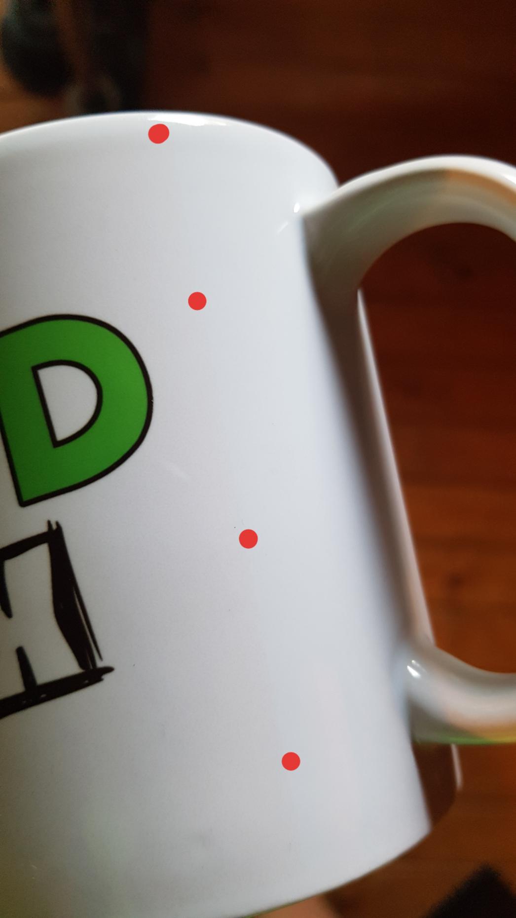

Hi webtrekker, the area is really faint, I've attached another photo, the red dots show where the problem starts/finishes. The area is exactly where the paper was applied to the mug and is only really visible in certain lights and if you look really hard. I've looked at a mug that I did a few days ago with the same image on and is absolutely fine? Cheers

I can see the line on the original (yellow) image. Run the eye dropper tool over the background and make sure that the background is RGB 255 pure white.
If it is pure white, then it could be that Photoshop is not picking up your ICC profile. Or some of your settings have changed. Photoshop can sometimes throw a wobbler.
Check that: Photoshop Manages Colors in Color Handling and the correct profile is selected.
Try re-installing your ICC profile.
Check that ICM no color management is set in your printer driver.
