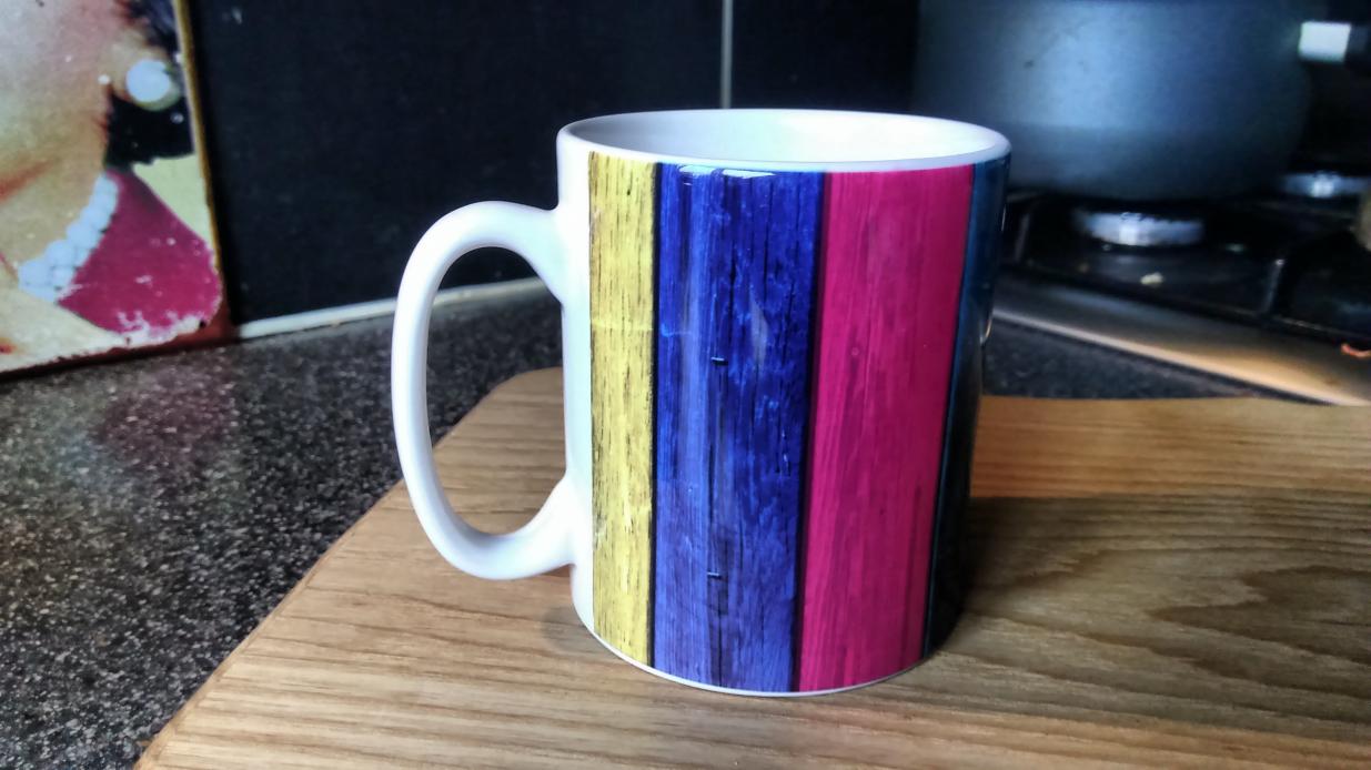

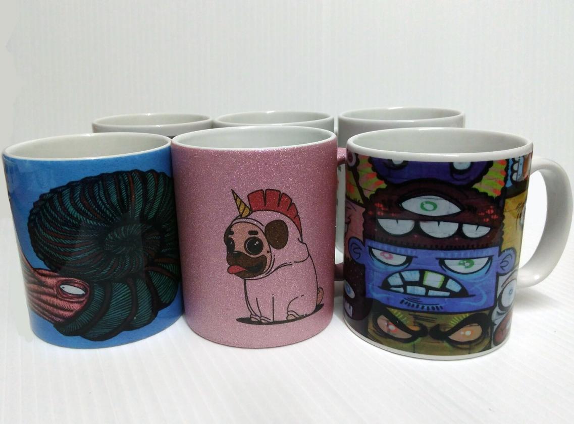

I currently just use a small halogen with wraps and get pretty good coverage.
.[ATTACH=CONFIG]6005[/ATTACH][ATTACH=CONFIG]6006[/ATTACH]
The stripey mug is a Listawood 10oz and the two outer mugs in the group pic are XP5013's

Re: top to bottom prints on mugs?
I suspect that contributes to issues. I keep meaning to try putting slits in the top and bottom of the paper (think fat tassels) so it can wrap around easier without it affecting the tension elsewhere.GoonerGary;141538 wrote:Mugs which taper off sharply is the main culprit. I've been experimenting with transfer size, wondering if the paper buckling beyond the edge of the mug was contributing to it, but it's hit and miss whether it works or not.
One of many things on the to-do list.
I normally put bottles on a little plinth to raise the height. Think I'll try it with mugs to help prevent any gassing as the paper buckles.
Although some of your mugs haven't been printed full top to bottom, whose mug is the blue crustacean on the left?
That one was one of the Xpres 5013's.GoonerGary;141551 wrote:I normally put bottles on a little plinth to raise the height. Think I'll try it with mugs to help prevent any gassing as the paper buckles.
To be honest I've never had issues with the printability of these mugs. For me it's just the longevity (or lack of) of the coating vs dishwashers compared to others that sadly let them down...if only we could combine these mugs with the Duraglaze coating.
