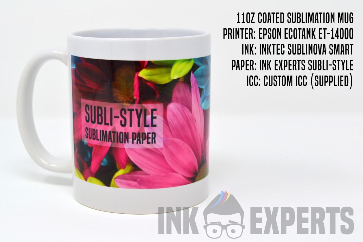

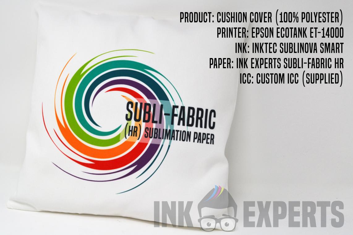

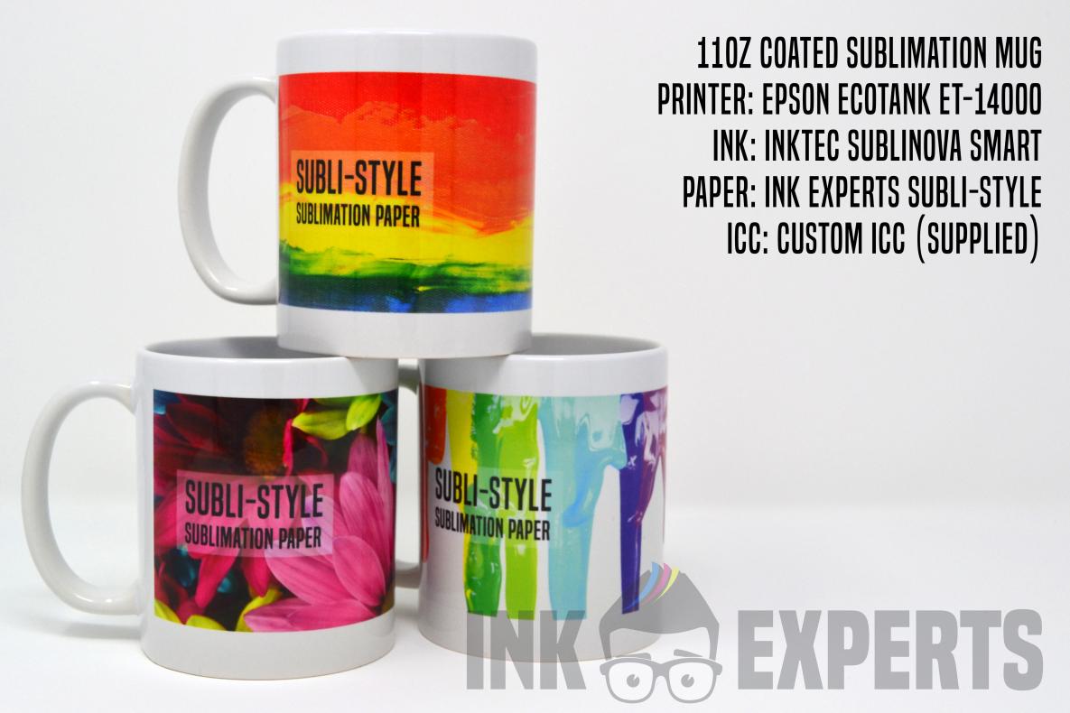

The ET-14000
vB_ID:5744
vB_ID:5744
As A3 printers go we considered the Epson 1500W to be the best for quality and affordability.
Nothing has filled that gap and the cost of A3 printers has risen considerably.
In steps the ET-14000.
Based on the 1500W, the main difference is the ET-14000 has 4 colours in its 5 ink channels (C,M,Y,K) rather than 6.
The price has also increased, but with the added benefit of an Ecotank we find this increase to be justifiable.
Colour quality matches that of any other 4 colour Epson printer, but the amount of detail in prints appears to be better.
vB_ID:5744
vB_ID:5744
vB_ID:5744
vB_ID:5744
vB_ID:5744
vB_ID:5744
We managed 320 A3 borderless prints on this printer before having to top up the tanks, and again the paper feed was more than capable of handling the throughput.
It has the same internal components as the 1500W and is therefore on the same page in regards to durability.
After being left for 2 weeks without use there wasn't even a single nozzle missing.
It just carried on as if it had been printing 5 minutes before.
As always we recommend using the printer more regularly, but we were staggered at this result.
In conclusion, if you are looking for a simple solution to sublimation printing we cannot recommend the Ecotank series highly enough.
