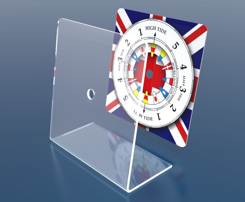

The reason I'm interested in FRP is to make desk/table clocks, such as my current Tide Clock design, which is made from a piece of clear acrylic, bent to shape, with a sublimated aluminium clock face. I was hoping to side-step the aluminium and print directly to a white stand, instead of the clear acrylic stand.
At the moment, I'm waiting for some white acrylic samples to arrive to see if I can sublimate directly to the acrylic ( it does conatin polymers, I believe). If that works, then I won't really need to explore the FRP route.

If you get CAST acrylic then it is sublimatable (don't get extruded acrylic as this won't work)
If you use clear acrylic to print onto, up the colour saturation, as the print will be transparent, white acrylic won't have this problem, and frosted is a nice halfway house. You can get recycled acrylic for around the same price, which could work well for an extra USP.
Frosted also good with a light behind it...

The samples I have on order are 3mm white cast acrylic. I hadn't considered the idea of using frosted! Could be a nice touch if it prints well.
It's important to me to be able to produce clean, accurate bends, which is another reason why acrylic may take precedence over FRP, provided the prints look good and I can control any warping/distortion of the pressed items.

When we did some acrylic work on A3 sheets for an artist, we used two PressMech presses - one for printing, and the other turned off cold and kept them under pressure in the cold press while they cooled to try and minimise the warping problems.
