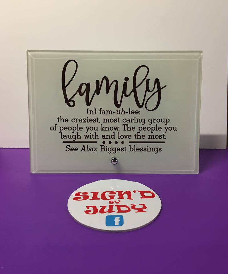

hi all , i have recently purchased the epson wf-2630 printer with refillable sublimation inks, it came with a icc profile on a disc
which i installed as guided to by the paperwork supplied.
i can print black no problem, but colour is not true colour even after pressing onto mugs or coasters.
the icc profile had instructions for using with photoshop but im using coreldraw x8
ive played about with settings within the program but im not getting anywhere.
i press mugs at 180c for 160 secs and coasters 185c for 65 secs and the slate was at 185c for 360 secs
the ink is sublinova ink from inktec and the paper is from inkexpress
would anyone have any ideas how i can get colours to come true please?
as you can see on the glass frame the black is lovely

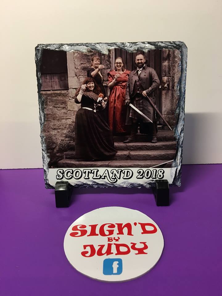

the photo slate - the colours are not bright and it looks sepia affect.

When pressing your slate do you cover it with a foam pad?
Are you sure the profile is installed properly?

hi yes its covered with a pad, i have fiddled about some more with the settings and think i may have found one that works for me :)
fingers crossed
thankyou for your help
Re: epson wf-2630 and coreldraw program
What did you change?
judy sewell
Posts: 4
Joined: 05 Mar 2019, 12:17
Post by judy sewell »
i changed profile from sublinova to adobe and colours are nice and bright
