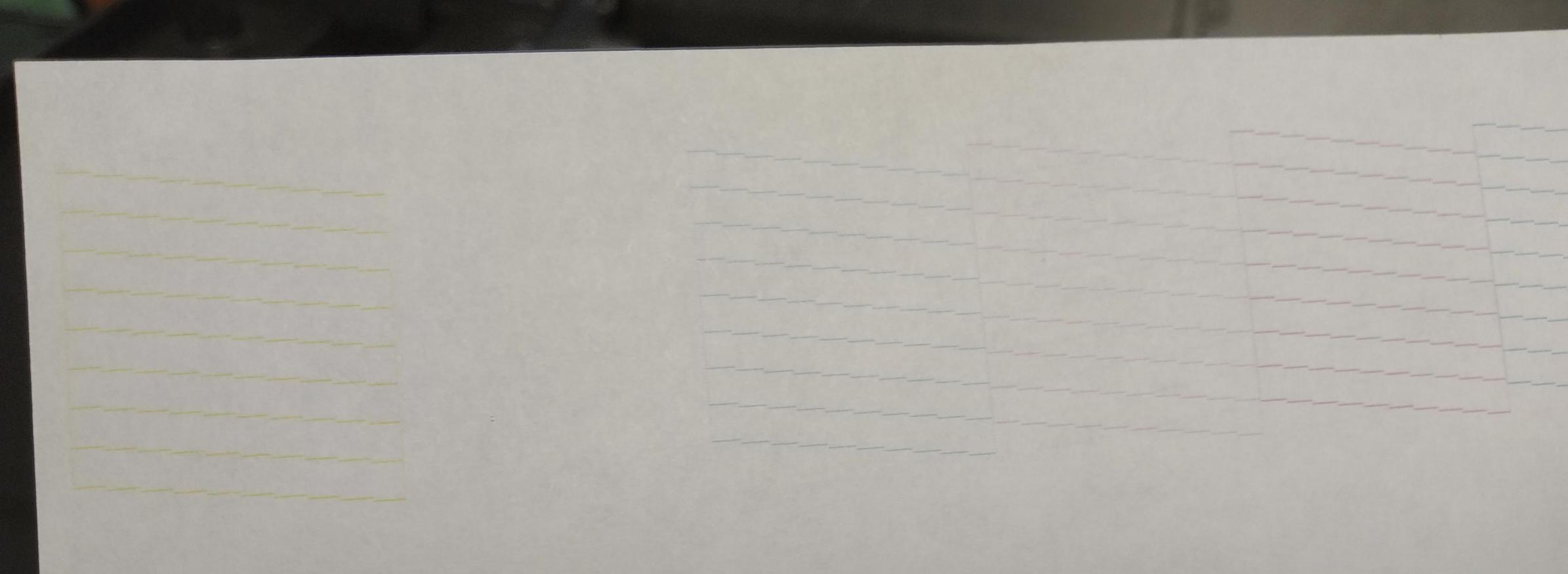

So I stopped using my 1500W daily as I was testing another printer. I still sent a few test prints here every couple of days to keep it happy. I've now found the black head is completely blocked! Inktec inks so I'm really surprised. All other colours are giving perfect nozzle check. I've put other carts in to prove it isn't the CIS and tried usual cleaning tricks but I get nothing, absolutely nothing. Seems so strange, normally you'd get something showing but black channel not there!
Gutted as it's not had a great deal of work through it since buying new, just small regular jobs.
So if I can't get it working (which is looking more and more likely) I'll have to look at a different model unless I can secure another 1500W from somewhere (emails sent to a few sellers!)
Failing that, anyone interested in buying it that may have better skills than me to clear the head? Or even for spares as it's otherwise spot on :-(

I read that doing one single head clean and leaving it for a couple of hours or overnight can help. Have you tried the cleaner from inkexpress, perhaps your fluid isn't dissolving the ink?
Re: Argh! Epson 1500W is dead!
Yes, started off with the usual single head clean, leave off for a few hours etc. but nothing is shifting it. I have a couple of cleaning fluids but perhaps not working with the Inktec inks.

I'm not sure if I've ever successfully brought a printer back to life, it's usually something more than a blockage. I normally use undiluted strong IPA for dissolving sub ink.
Yes, I was thinking the same myself. Anytime I've had bad blockages the printers have been scrapped. I've not tried IPA yet but will have a go now. I don't want to destroy the printer as it 'may' be of use to someone more technical than me but maybe one last try :-)
Well guess what? this is what I've seen last few days....
vB_ID:5615
vB_ID:5615

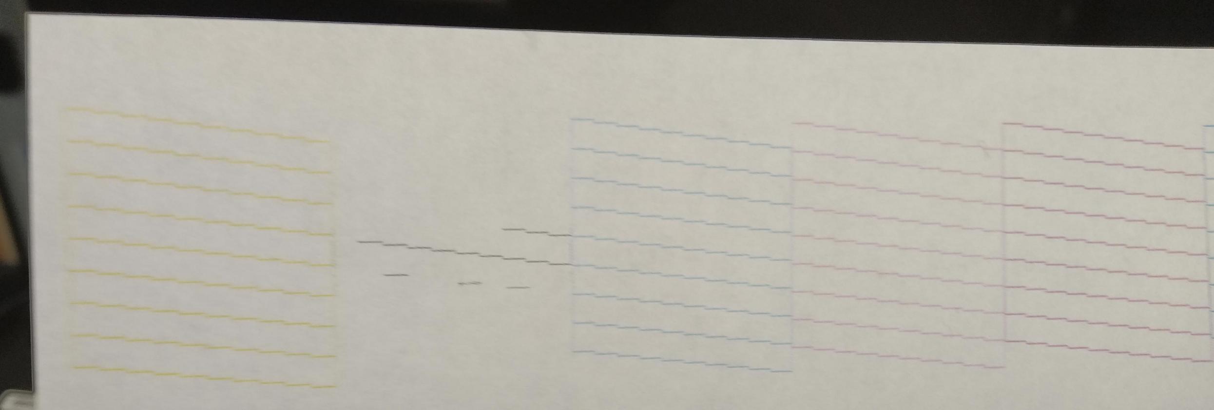

So I've been persevering today......
vB_ID:5615
vB_ID:5615

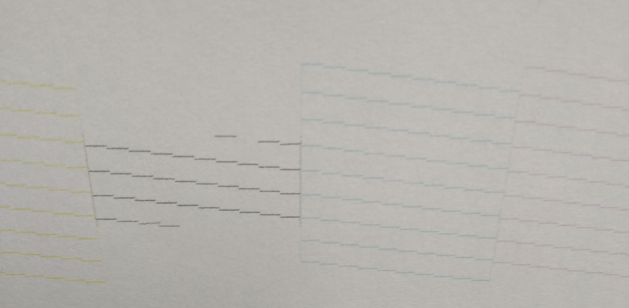

First sings of black coming through! So, I persevered....

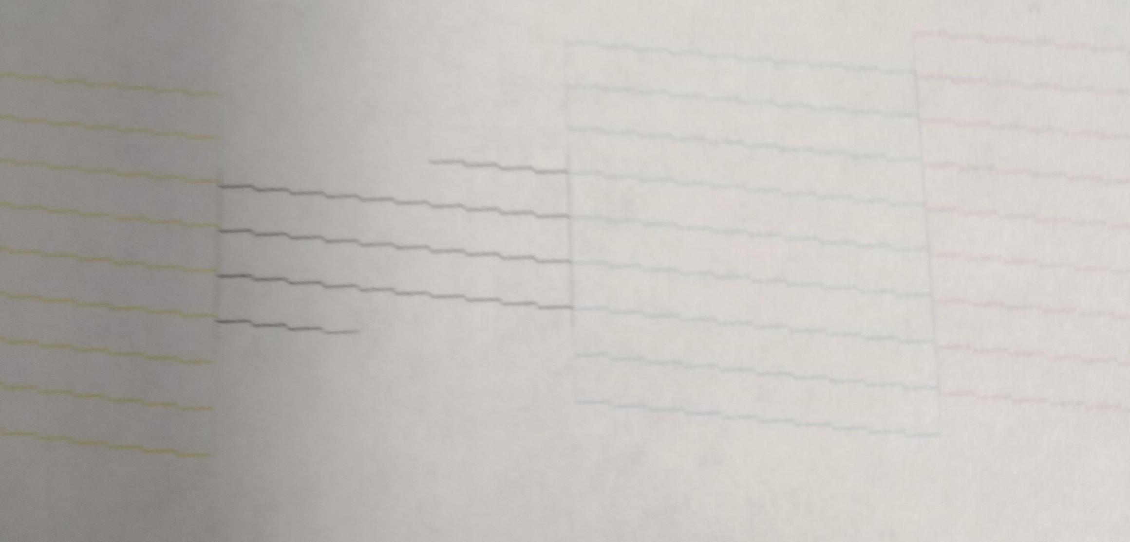

Better still! But not quite there......

Slightly better....keep at it!

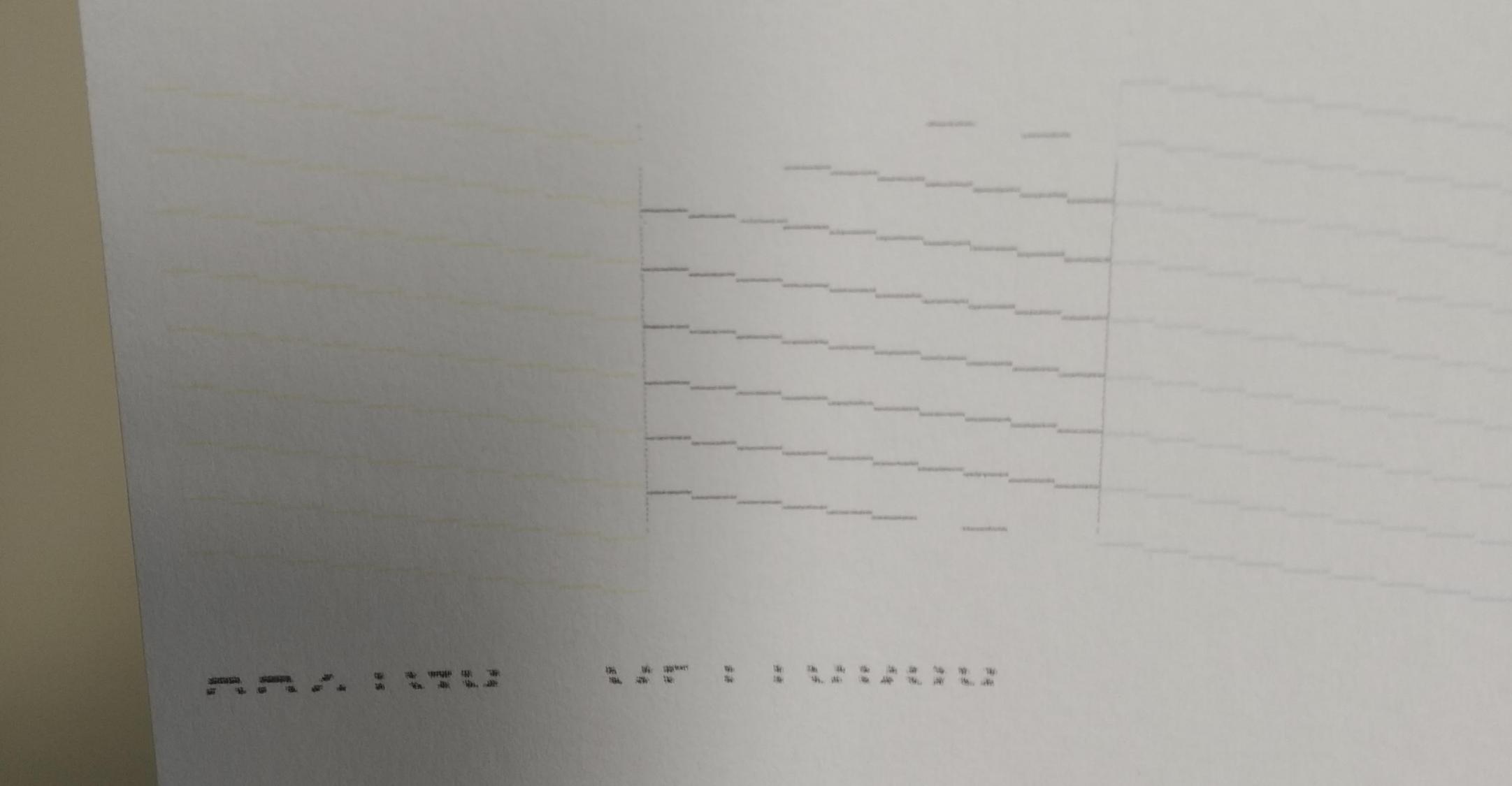

Now, I feel I'm getting somewhere :-)

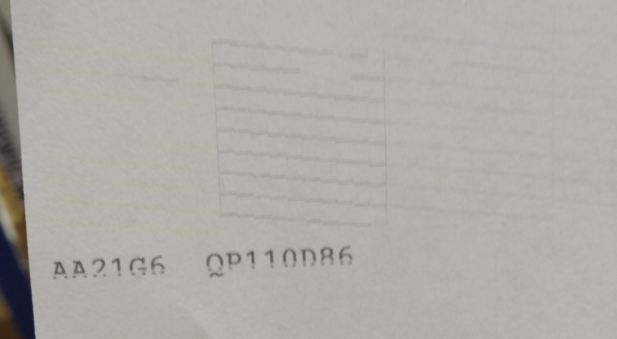

Is it wrong to get so excited over a little nozzle pattern.......

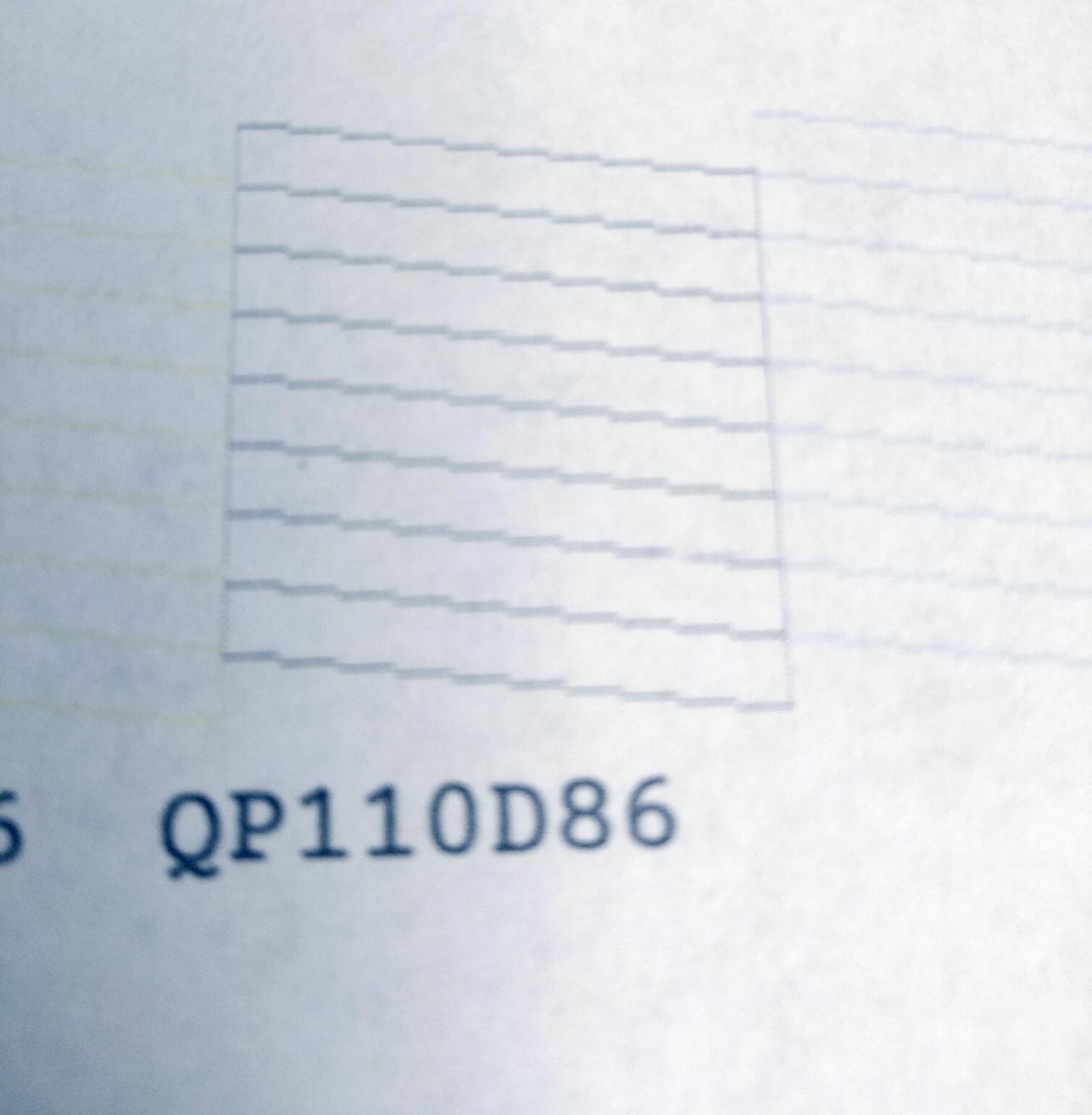

I guess I could have just posted this next image in the first place but where's the fun in that!
vB_ID:5617
vB_ID:5617
Yes, I have 100% black showing on nozzle check! So how did I do it? Not telling......oh go on then. GoonerGary mentioned above using IPA so I cracked a bottle open. Soaked a rag and pushed it under the carriage ensuring it was touching the heads. Hour or so later I started to get the first result above so tried just 1 or 2 head cleans, slight improvement. Soaked again for a little longer and results just kept improving. Third time I left longer, I wanted to leave overnight but I'm always too impatient. So, last couple of pics were the result and I can clearly see black ink soaked into the rag so looks like it dissolved the problem!
I did the usual 2 head cleans and it was really good but just not quite there. OK, break that rule and do a third.....everything spot on! Time will tell but I'll be testing every day to see if it's printing ok.
After what we said about never rescuing a printer from a block I'm chuffed to bits. A small victory but one I'm heading home with to finish up another crap week on a high!
