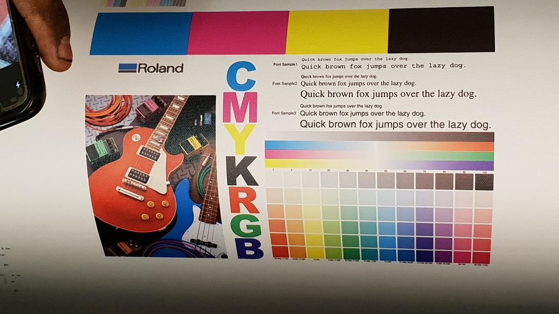

I managed to change a head and I think its successful , I couldn't find a techie that could fix it asap so I did it my self .I was bit nervous but just gave it a go .Took about 2-3 hrs including head alignments so not too bad as these days business a bit quite too lol, Got a great support from Scotty:smile: too ..Its firing all the nozzles now :biggrin:..I think it needs a very small adjustment you can only see on the really small fonts but will deal with it later ...
