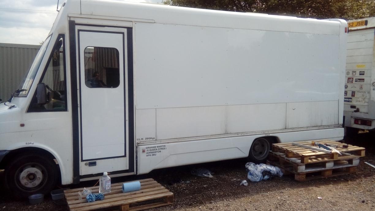

I use our local Dorotape for ours. I clad the sides of my bus conversion in the Alu panel

[ATTACH=CONFIG]6610[/ATTACH]
That is it after the panels were added, all of the windows were taken out, and aluminium extra supports added, then the panelling, then we cut out windows from a caravan and added them, it is still in use, in Bristol.W3sty3oy;147769 wrote:Would love to see pics of the bus?
