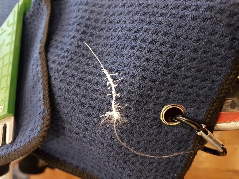

Here's a typical thread break - this shortly after replacing the needle! I have polished the rotary hook with the abrasive cord too.
[ATTACH=CONFIG]5982[/ATTACH]
This happens all to frequently!!

Earl Smith
Posts: 1323
Joined: 18 Jan 2012, 09:17
Re: Frequent Thread Breaks
Post by Earl Smith »
This is happening on my old Tajima 4 head and occasionally on the Barudans. Ive changed everything except the needle plate. After xmas Ill try changing these to see what happens. Maybe its the little looping guide, just above the needle that needs to be changed. Damn annoying though.
