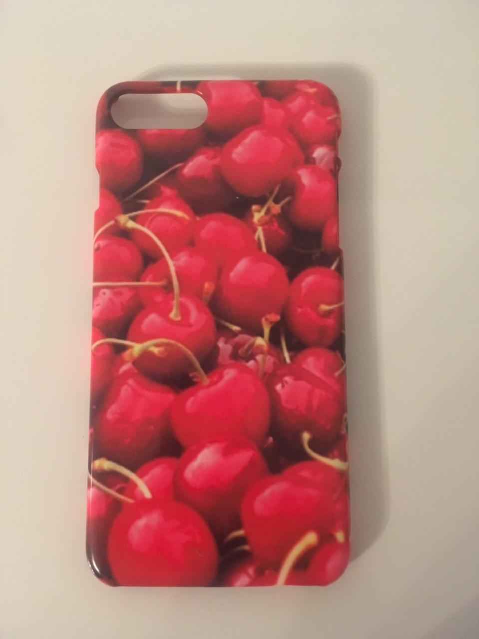

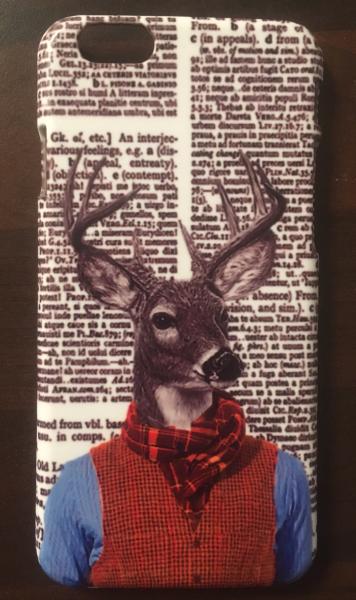

Here is a picture of the cases we design ourselves that dont cause me these issues...
vB_ID:5513
vB_ID:5513
