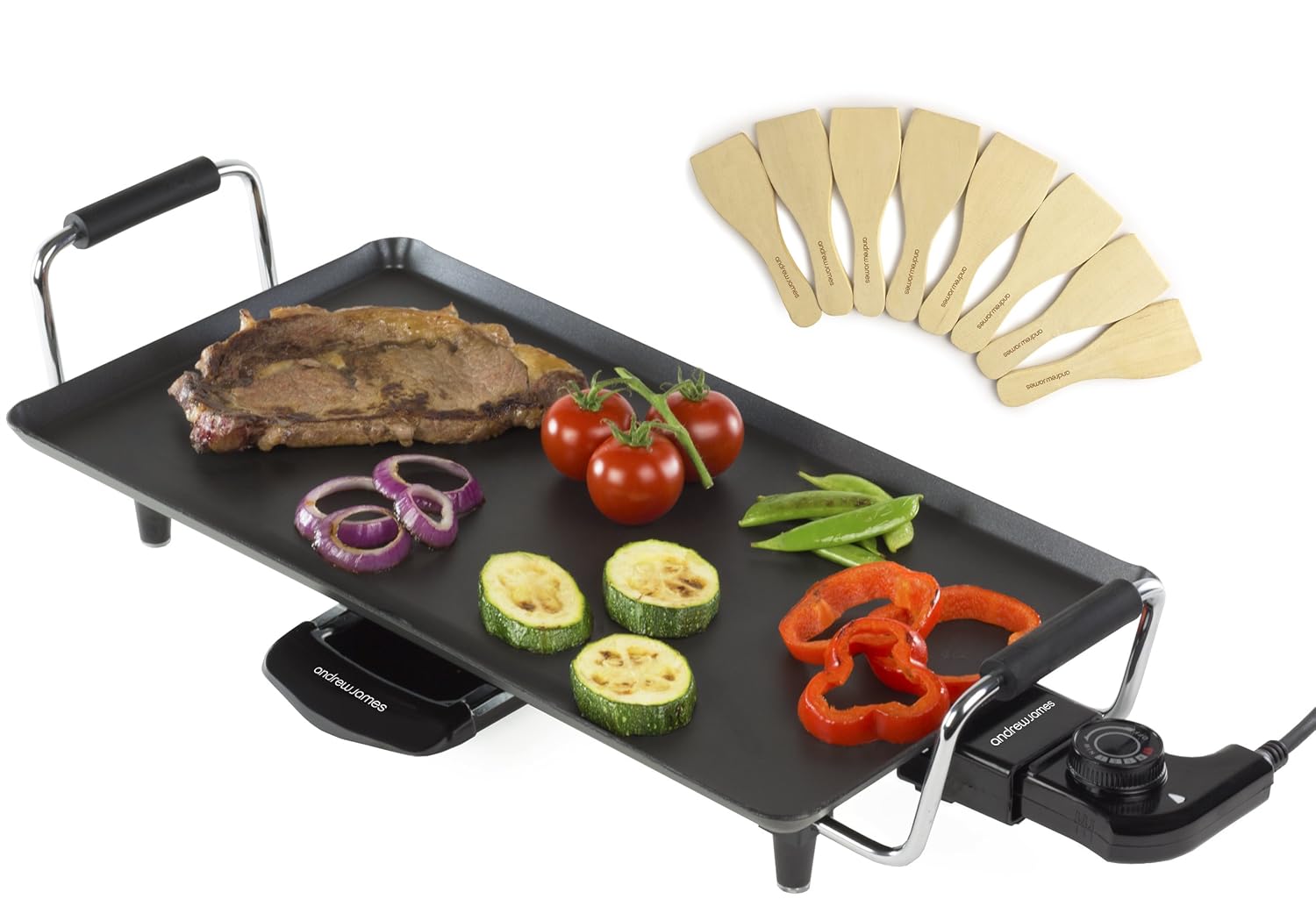

In colder months when the room is freezing overnight, I get out the Andrew James grill, you'll get about 8 mugs on there. Put it on the lowest heat for about 10 mins and that resolves any problems.
Some mugs are thicker at the base, but quite thin elsewhere, the 10oz Listawood mugs for example, so the heat sink problem is exaggerated. I find that the Xpres mugs are more solid all round, so I don't generally have the fading problem.
https://images-na.ssl-images-amazon.com ... L1500_.jpg

Someone on here used to use a hotplate, like this https://www.amazon.co.uk/Invero%C2%AE-E ... B0182JHI5A
