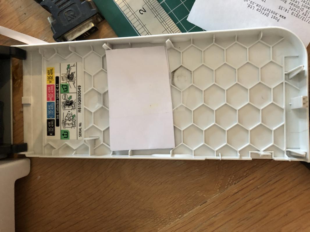

Re: Ricoh SG2100N error code??
One thing I tried, which seemed to work was to fold a small sheet of paper and taped it to the inside of door to the cartridges. I think someone somewhere else suggested that the error could be to do with "lack of pressure". So I theorized that it could be to do with the firmness of the cartridge's contact with printer internals - may be due to just wear and tear. Taping the paper just increases the firmness of the contact.
I wouldn't be confident of saying that this is the definitive answer. It could have just been luck!
[ATTACH=CONFIG]5997[/ATTACH]
Just found the link to the other post that suggested it was something to do with pressure: https://www.dyesubforum.co.uk/vbforum/s ... -Dodgy-ink
I have contacted supplier with this error code off and on for a few weeks, turns out its something to do with yellow ink, not enough pressure or something like that.
