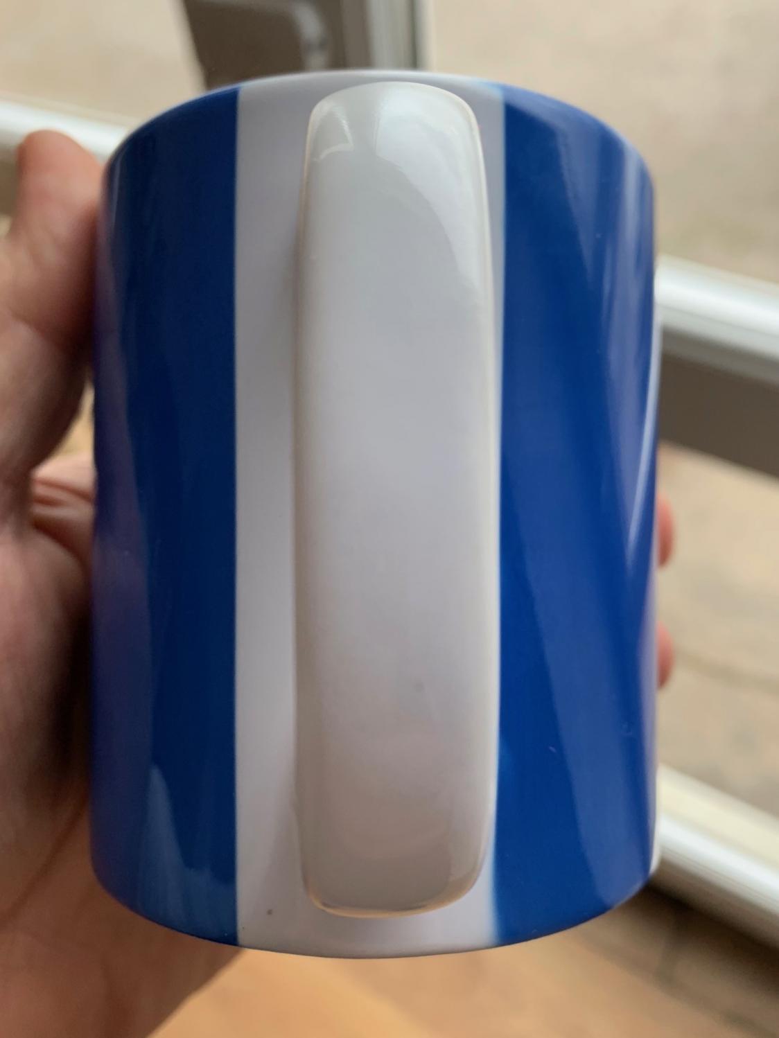

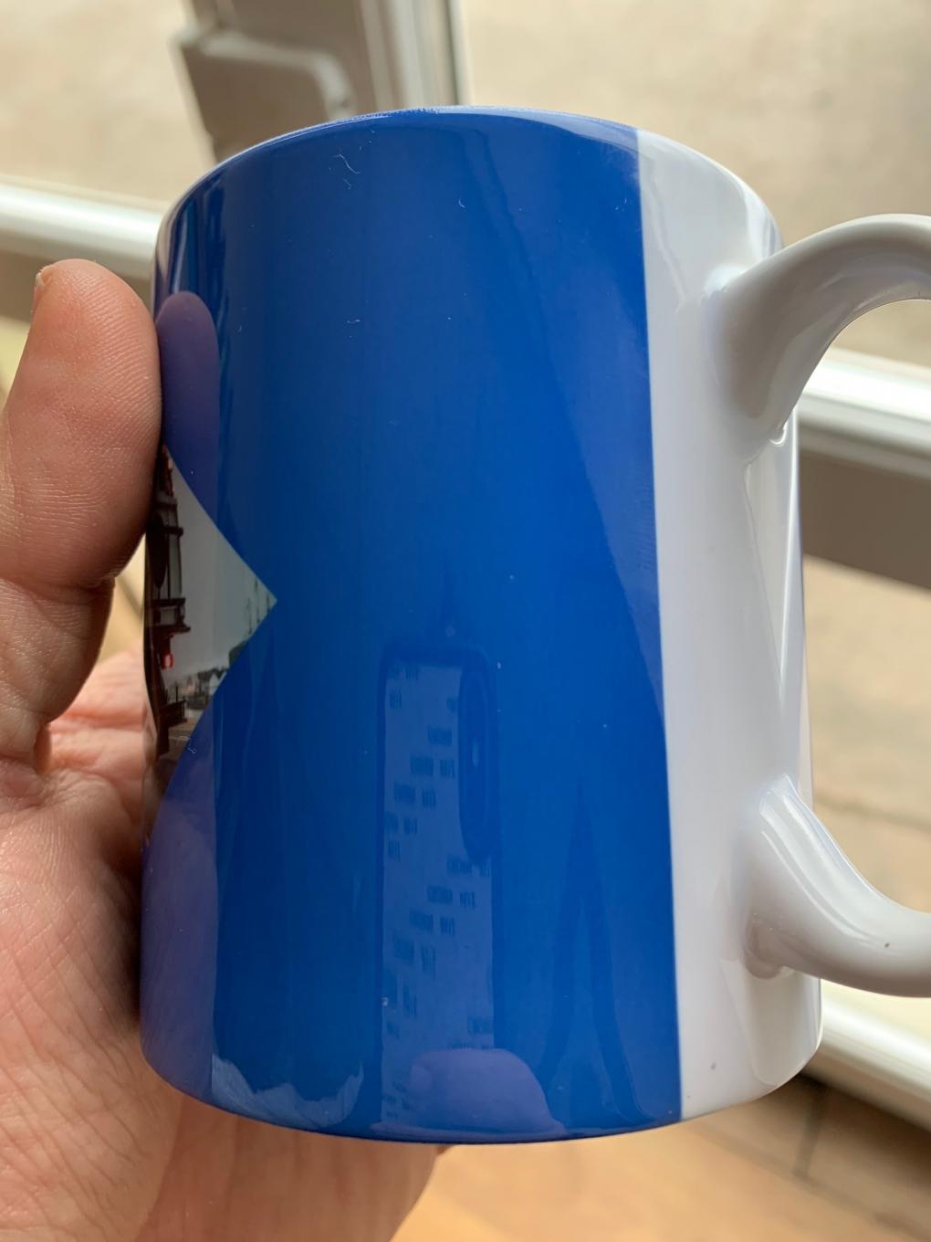

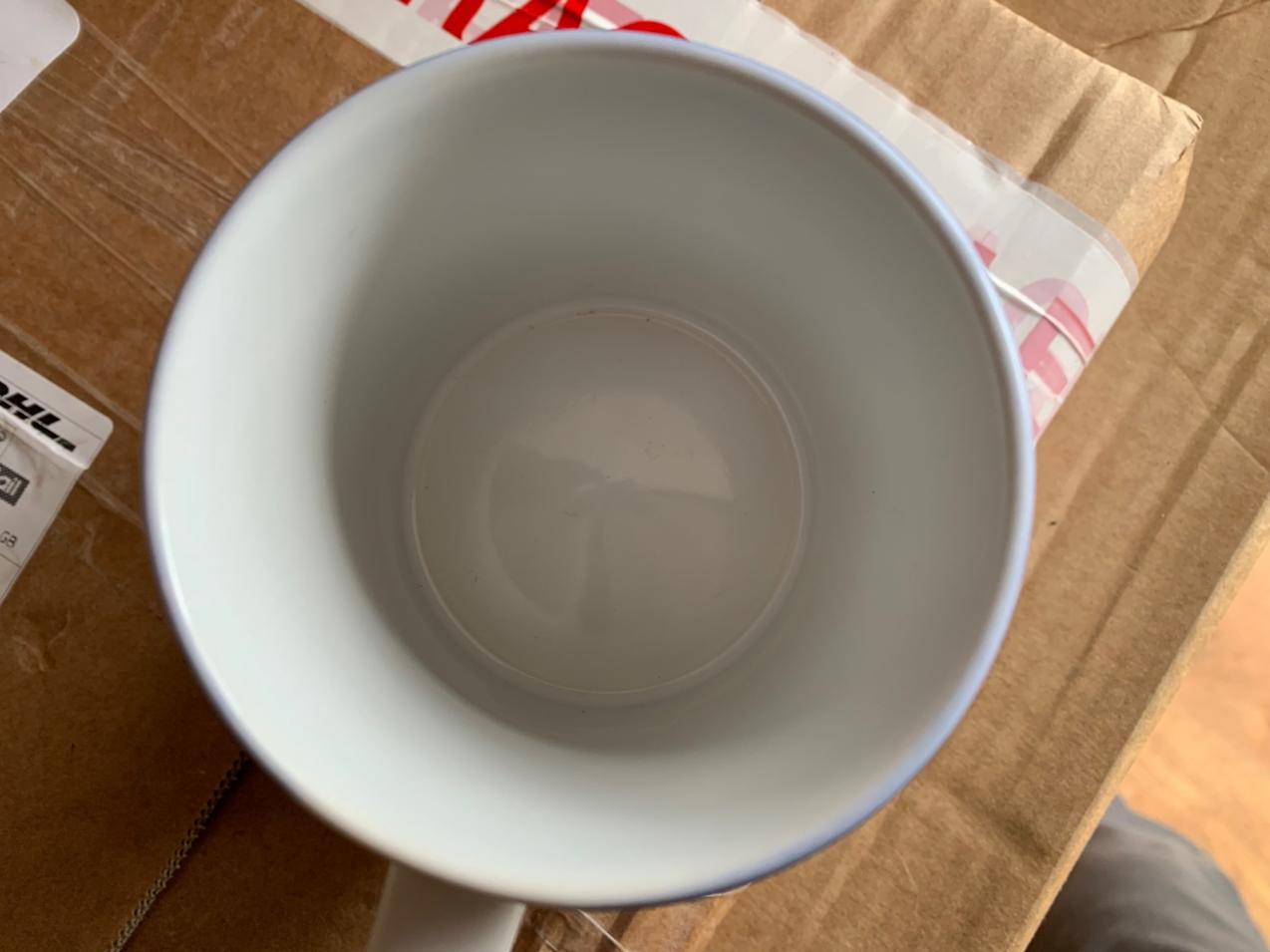

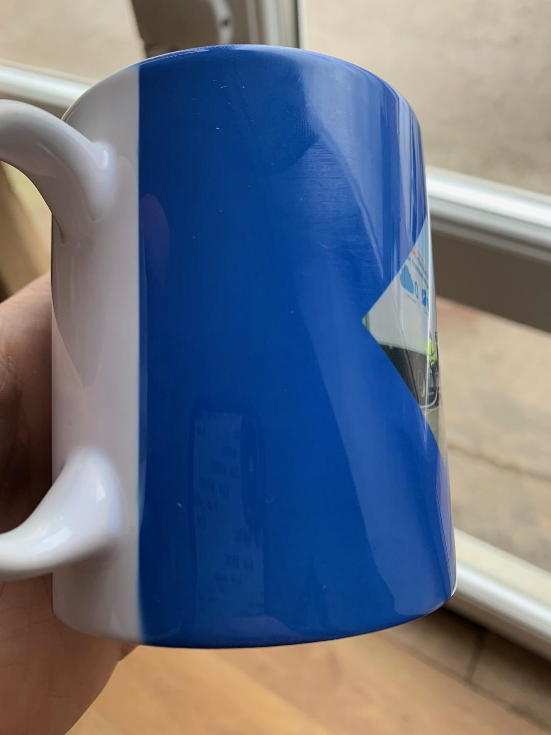

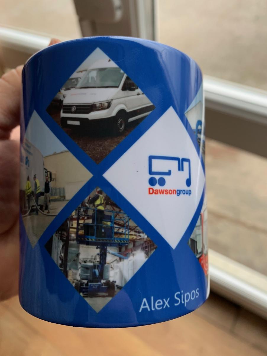

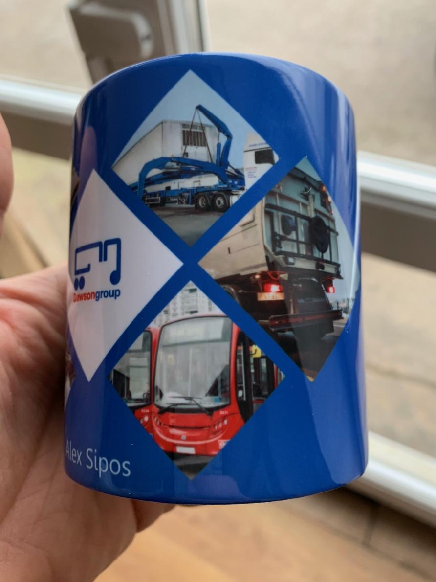

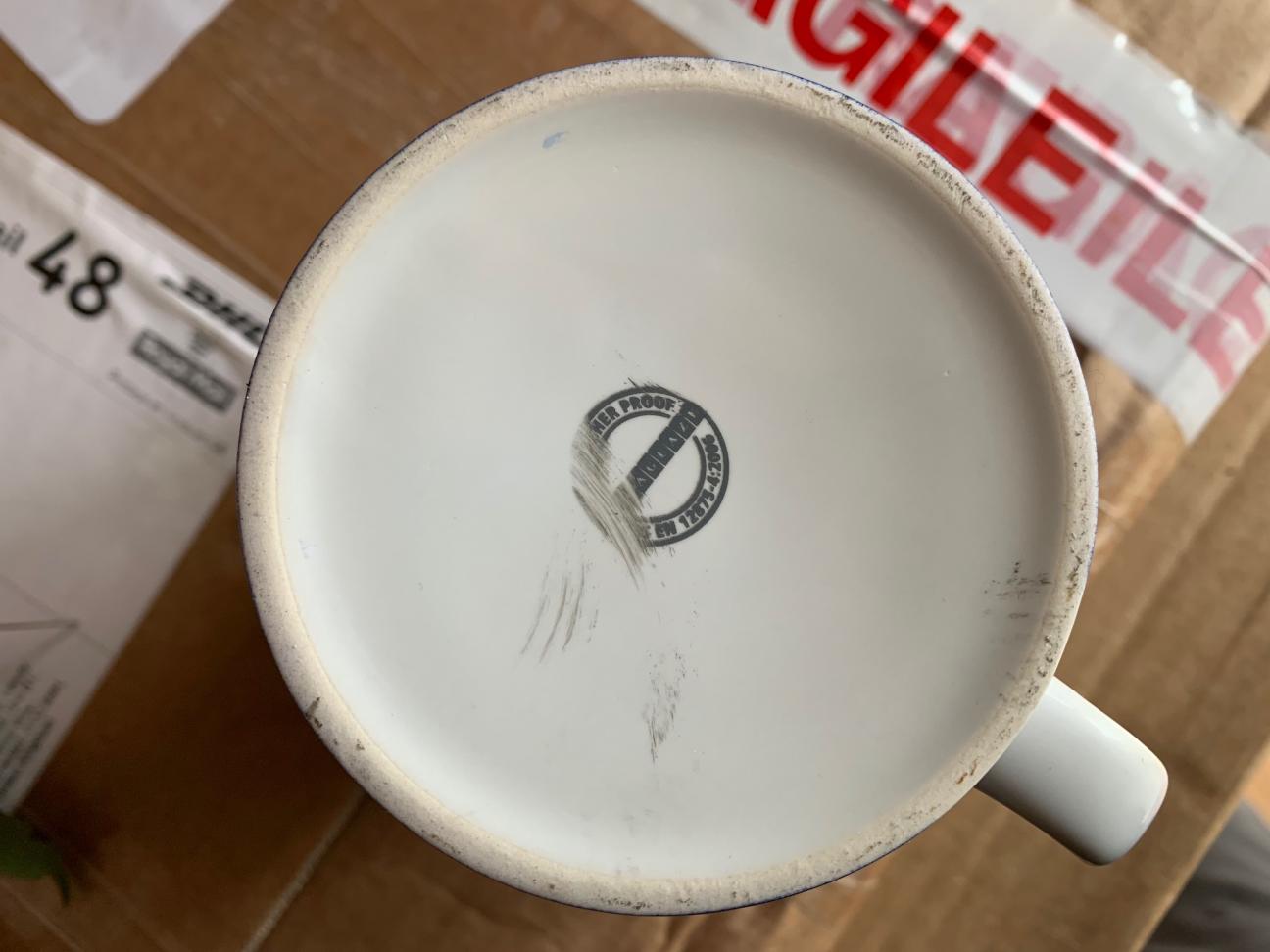

Printed in an oven using a well used mug wrap 9. Last batch I purchased was in Septemeber 2017 at £2.15 per wrap.
Paper used was Ink Express Subli Sharp paper and Ink Express third party Ricoh ink
This mug was obviously rejected because I have gone a bit too close to the handle and it is slightly blurred.
Item was printed, taped and the silicon wrap placed. No foam and no additional paper was added.
Please note that when the silicon wraps start to get dirty (after about 50 odd prints) I pile up about 30 odd wraps and put in the oven for 10 minutes at a really high temperature. This gasses off the excess ink and brings the wrap up like new.
There is no faffing with a wrap, it takes less than 3 seconds to add a wrap to a mug.

Re: Teflon Sheet when using Halogen Oven?
Show me a photo of top and bottom of the same mug, then we will continue the conversation
Hi BoyanShow me a photo of top and bottom of the same mug, then we will continue the conversation
Please see images, sorry if I am getting confused on your request and if you require a different angle or close up of a particular area I am happy to provide it
It must be the paper then that you are using is better. I use the Texprint HR and it leaks at the back and makes the wrap dirty.
My mug wraps are pretty tight and i can not achieve your result without the foam. Will have to buy that paper you are using and test.
The only paper i ever tested that will not leak at the back is the DYE SUB MAgic which was ways better than the Texprint but have to order from UK as in Spain i dont have a provider
