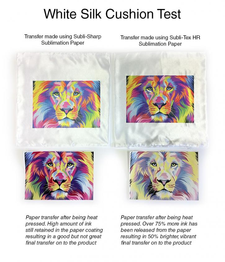

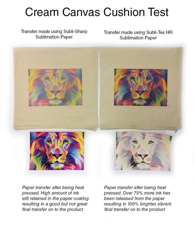

The ICC will help with colours, but often pale colour on fabrics is down to the paper. So it is worth trying a specific high release paper before making a final judgement. The other thing to look at is your t-shirts, my favourite sublimation t-shirts are Subli-Plus (XP520) from Xpres, I have also tried Gildan which are good. I find the Xpres shirts to be very good quality and the difference compared to other lower quality t-shirts even with the same ink and paper is quite shocking.
If you need software to support ICC and colour management try GIMP which is free, or Serif Afinity which is around £50.00. I love PS and use it daily but I wouldn't fancy purchasing it myself (we pay monthly through the business account)
Please see the photos below that demonstrate the difference between the two papers I sell on fabrics (all produced with the same printer, ink, software, heat press, product - just a different paper)
Alex
Alex

- Silk_cushion_test.jpg (91.63 KiB) Viewed 235 times

No problem, definitely consider a high release paper. It makes a world of difference
