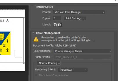

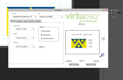

If you have virtuoso folder monitor running in the system tray then you can print to virtuoso using photoshop, the monitor will pick this up and open the printer dialogue. I believe you can drop files into the folder but not had to do this yet. Having used powerdriver and icc in the past I really like this program.

Re: Have Sawgrass stopped Powerdriver??
If you're using Photoshop though, do you need to use anything except the printer driver, and have PS manage colours with the ICC profiles
wayupnorth
Posts: 319
Joined: 30 Jun 2014, 20:09
Post by wayupnorth »
No, profiles already incorporated into vpm which simplifies things.

Post by Phill »
I upgraded to VPM 6 a few weeks ago, now I cant print from photoshop or illustrator,also gets the paper size wrong when using creative studio, its made it unusable, this is on my mac, I not going to upgrade on my windows computer, so I can still use it. Just dont know whats happened.
