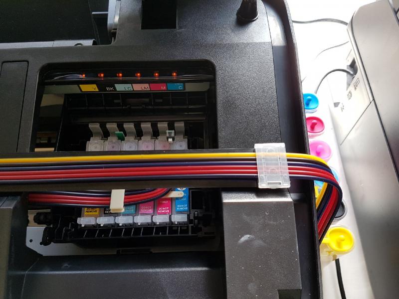

Morning folks,
Bought brand new Epson 1500W which came with ink in the lines .. trying to install inks but can't get the row of lights to go out. Resetting the inks by pressing the white button doesn't work, I've tried that multiple times, as I've tried taking out the carts and making sure they clip in. Even switching off and on does nothing either.

Yeah I've done all that .. waiting to get in touch with Inkexpress tomorrow to find out what else I can do, just thought I'd try you lovely people on here first. Will upload a pic for you to see.

Epson 1500W CISS.jpg (66.05 KiB) Viewed 549 times
This is how it came to me and after I installed it. As you can see the link lines are filled with ink.

Same as mine. It' sounds like you've done everything, re-seated carts, pressed the button. Have you tried pulling the power lead from the back (whilst printer on) leave 5 mins and switch back on?

you haven't pressed the carts in enough - I had exactly the same problem with my new one about 2 weeks ago. I was scared of breaking it. I phoned the supplier and they told me to give it a firm push using two hands. It is quite a loud click when in properly and then the lights go out and the printer starts charging.

loobyloo;130541 wrote:you haven't pressed the carts in enough - I had exactly the same problem with my new one about 2 weeks ago. I was scared of breaking it. I phoned the supplier and they told me to give it a firm push using two hands. It is quite a loud click when in properly and then the lights go out and the printer starts charging.
We have a winner, quite ashamed to say that this burly 6'4'' bloke hadn't done exactly that. Sorted now .. thank you so much :redface:
