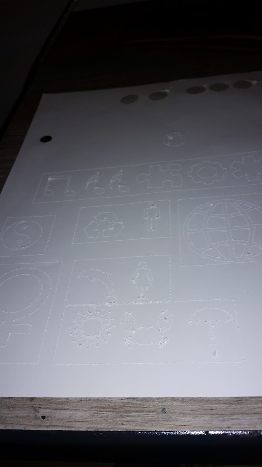

Impossible to cut properly with my roland GX cutter with brand new knife on slowest speed and lowest tuned pressure. The top surface layer scratches and "dusts" . See picture. With scissors is ok, so no problem there. My roland is in like new shape and cuts perfectly whatever material i throw at it, so the problem is in the outermost layer of the paper.

It would have been an ideal material as advertised for dark cotton T shirts, if it was able to cut without rough edges. Basically i could say its good for logos or whatever, if you print borders same color as material and cut over them. And handle it with care.

Just uploaded the image.
I am cutting it with brand new cutter blade on a Roland GX that cuts very well anything else. And yes, as slowest as possible and as light as cut as possible. 60g down force and the blade is perfectly set at half credit card. I cut thick flock at 120g, so i dont think problem is there.
I am trying to cut it as for example i would like to use it for printed logos and letters, not ugly bulky square pictures, for which obviously it works. In fact its a vinyl, not paper exactly. But the thing is it have a very funny outer layer that maybe is the layer that accepts the ink. So said layer will not cut but rather tear.
Is there another paper that could cut correctly and could be inkjet printed??? And no, this paper is not a cheap paper, its Iron On Dark paper at 2euro per sheet.

It does look very strange. I was able to cut any paper on my gx. Is your artwork a proper vector with clean lines? Or auto traced? Autotrace is not great with lines and sometimes put more then one cut line one under the other And this will cause cut in same spot few times.
Re: Iron On Dark paper
Also this look like you cut through your backing paper?
