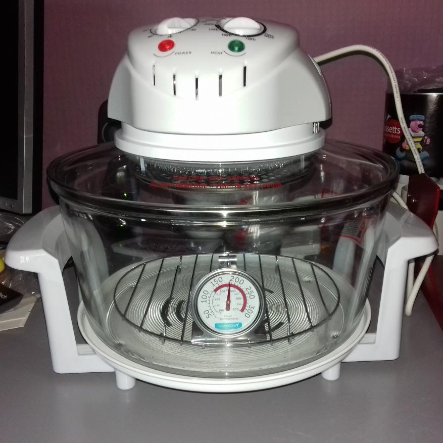

[QUOTE=webtrekker;128436]I thought I'd try a halogen mug oven to see if there were any advantages/disadvantages over a mug press or a conventional electric/gas cooker.
Well, I only received it yesterday, but so far the results are excellent!
This is the oven ...
You may notice that I have an oven thermometer in there too. This is because you can't trust the temperature dial to give you the exact temperature you need for sublimation. With the dial set at 180 deg C it was only measuring 160 deg C on the thermometer, so I fiddled around and now have it 'cooking' at 180 deg C. The thermometer was £3.99 from Amazon.
I've now got it down to 10 mins to print a single mug, using the cheap (less than a fiver) silicone mug wraps from ebay. I haven't had time to try 4 mugs yet but I'll get around to it soon.
The prints blew me away! MUCH sharper than any I've produced with my mug presses, particulary small text. Colours were great and uniform, and black was very black, not brown. Inks and paper are the same I've always used, from City Ink Express. Mugs are 10oz Listawood Duraglaze Durham AAA.
These ovens only take a few minutes to reach temperature, which is good. The very bright light of the halogen bulb switching on and off is a bit annoying when I'm working on the computer at the same time, but bearable. You can hear the blower but it's nothing excessive and the only other sound is the timer ticking.
All in all, it looks like I'm going to be doing most, if not all of my mugs in the oven from now on. :wink:[/QUOTE]
