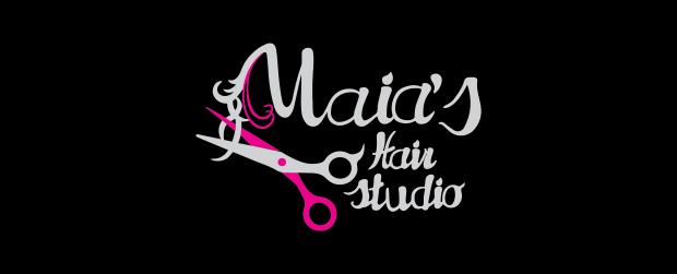

I'm trying to print a following design, design should have a black background, which is the biggest problem by far :).
vB_ID:4937
vB_ID:4937

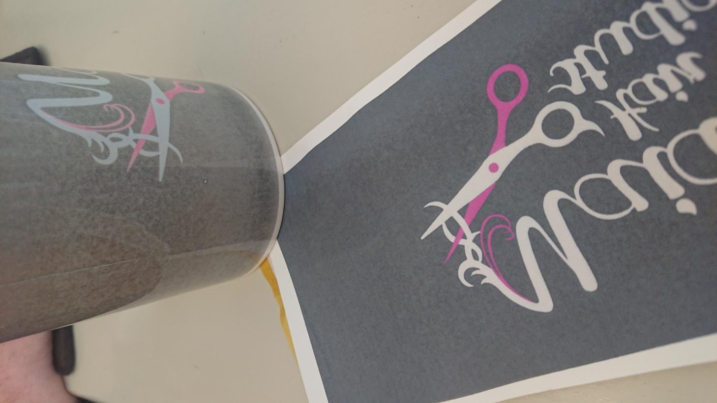

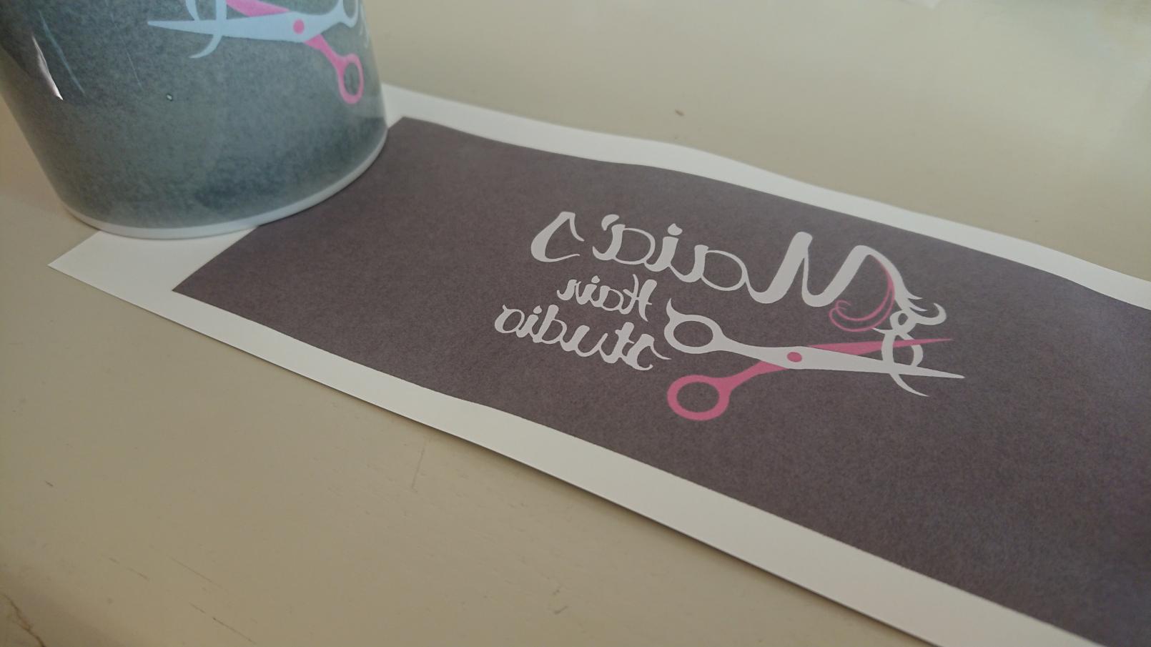

Here is how the print out looks before sublimation:
vB_ID:4937
vB_ID:4937
Here is how the printout looks after sublimation:
vB_ID:4937
vB_ID:4937

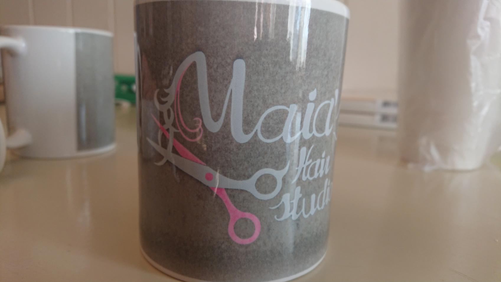

Here is how the mug looks after sublimation:
vB_ID:4937
vB_ID:4937
So Black is actually Gray, and pink on the scissors is much to pale.
Any suggestions are welcome.

Re: Adkins studio Multi mug press and my first Mug
That 'before sublimation' printout looks terrible. Are you printing on the correct side of the paper? Are you using Sawgrass Powerdriver or an ICC profile?
Most sublimation on mugs is done at around 180 degrees C for around 180 secs.

Webtrekker,
Thanks for your help, didn't realise that there are 2 sides to sublimation paper :redface:.
After turning the paper around I used 180/180 and I got a perfect black.

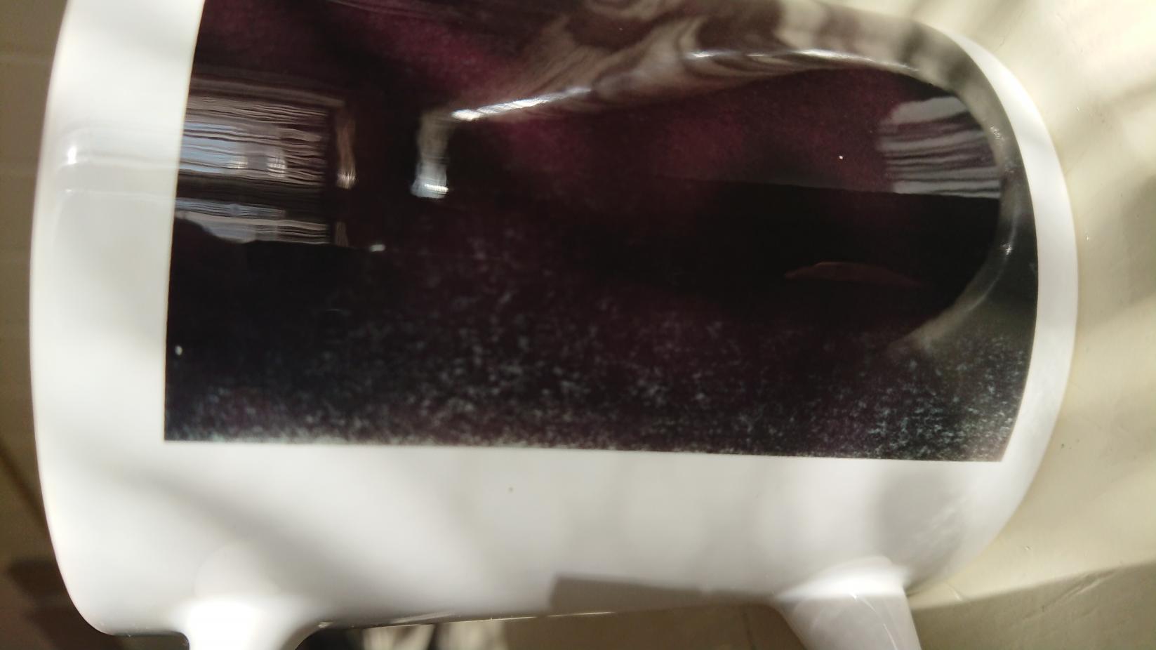

The only issue remaining are the edges relatively close to the handle, they have bright-ish spots.
vB_ID:4938
vB_ID:4938
mug 2.jpg (81.16 KiB) Viewed 267 times
I tried different pressure settings, looks like more pressure the better, do you have any other suggestions??
Many mug presses don't do too well near the handle because the handle, and also the thick base of the mug, acts as a heat sink and draws heat away from the parts of the print nearest to them.
I get around this, to some extent, by pre-heating my mugs to 100 degrees C before the final press but, to be honest, if you want full coverage of the mug you'll be far better off reading the posts about silicone wraps and mug ovens. I can produce a nice, full wrap, from top to bottom and very near the handle, with no fading, using a silicone wrap (costs about a fiver from ebay) in my home kitchen gas cooker, or you can buy a halogen oven for around £30 to £60 to use as a dedicated mug oven.
