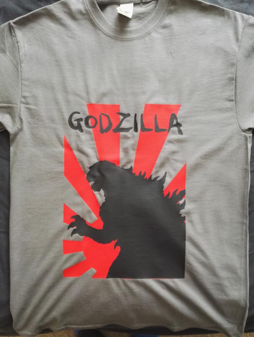

No, the vinyl sit well on top of each other. When pressing you need to make sure that you don't overheat the vinyl i.e bottom layer for maybe 5secs then peel and place the next layer and press for 15secs. The times depend on the vinyl but I use Xpres which is 15secs.
You could experiment with out cutting the purple layer for the text and just layering the white lettering vinyl on top and see how that goes. I did this with a t-shirt.
