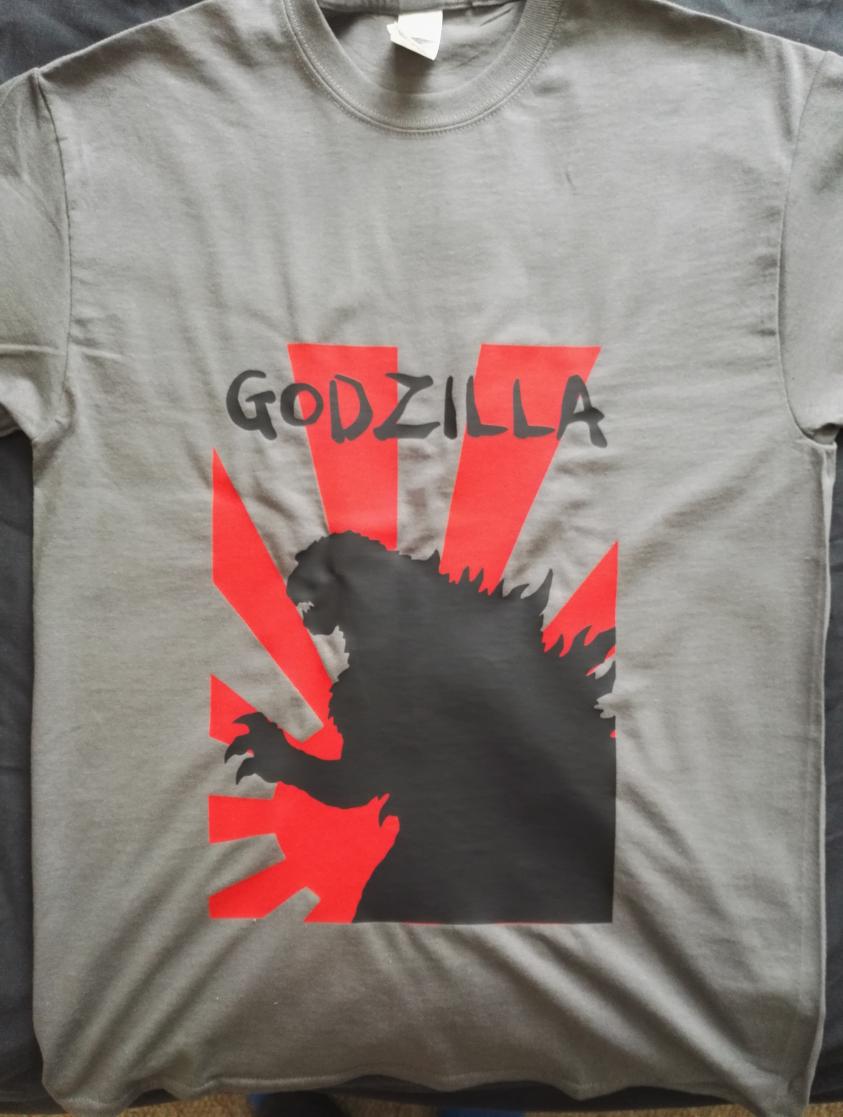

Ive just finished making a t-shirt for a friend.
There are 2 layers of vinyl, pressed each layer for 10secs each and then pressed for another 5-10secs after backing removed. I think it's come out alright. You can faintly see the vinyl underneath so next time I would cut the vinyl more to each shape (like puzzle pieces).
[ATTACH=CONFIG]4832[/ATTACH]
vB_ID:4832
vB_ID:4832
Earl Smith
Posts: 1323
Joined: 18 Jan 2012, 09:17
Re: Layering heat vinyl on a t-shirt?
Post by Earl Smith »
Hi Coops,
With that logo I would have cut out the text and Godzilla from the red and not layered at all.
Coops
Posts: 174
Joined: 30 Sep 2016, 18:18
Post by Coops »
I thought that too, after I pressed it lol.
My only concern will be lining it up, should I make it marginally bigger so there is a slight overlap?
Earl Smith
Posts: 1323
Yes, I would have made a slight overlap too. 2mm would be enough.
