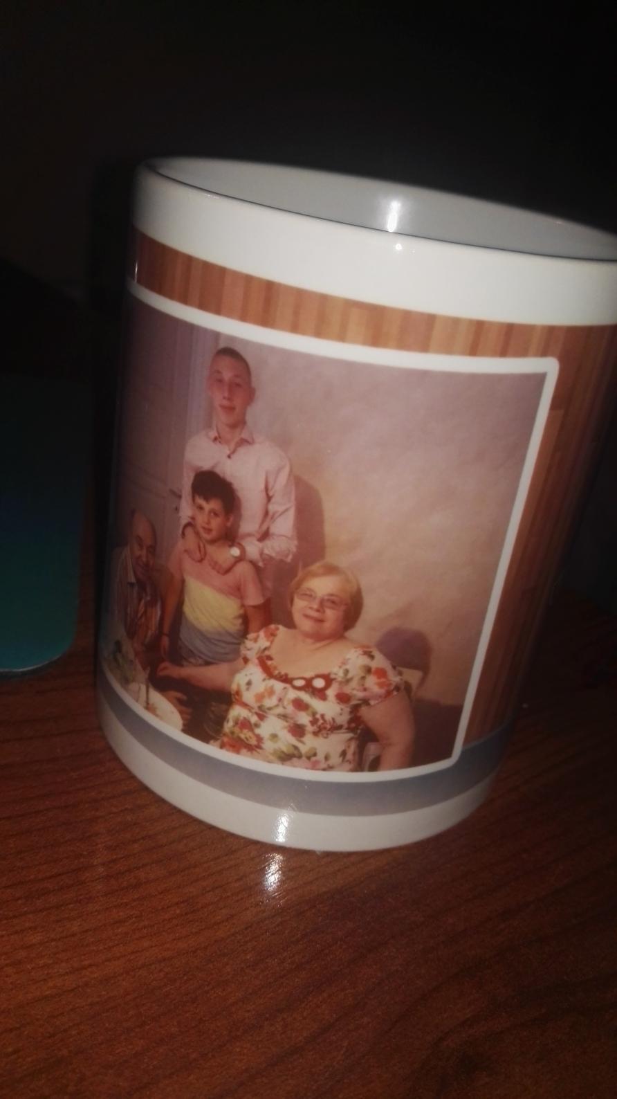

Hi, i have heating press JTrans and epson l210 with sublimation inks. This mug is made at 110degrees low temperatue, 180 degrees high and 180seconds, but I don't know if can you see well on the bottom the color is faded and it's not good. So can you please tell me if the temperature and time that I used is right or not?

Id personally try an higher temperature also are you putting the mug far enough into the press. Ive found if one end of the mug is to close to the edge then it may come out faded there.

@Aneta - Try pre-heating the mugs before the final pressing. I pre-heat mine to 110 degrees C in a second mug press then transfer to the main press at 180 degrees C for 180 secs.
