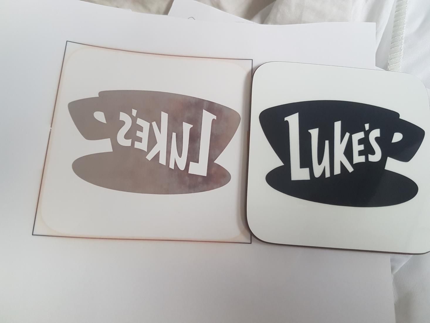

I've been printing coasters for a few months and for the most part it has been relatively easy but this evening I've been printing a relatively ink-heavy logo and the results have been odd.
It seems that half of the logo isn't transferring nearly as well. See attached photo.
vB_ID:4671
vB_ID:4671
I hope everyone can see that ok - let me know if not, I'm still learning how to use the forum :)
It seems like the area around the L hasn't transferred as well. As you can see on the coaster it isn't very obvious but if you look closely in certain lights it looks blue instead of black.
Are there any coaster experts that can help me out?
Thanks! :)

I had a similar problem with a company logo that had a solid black background. From memory I think I upped the temperature a little and also increased pressure.
Hope that helps.

Ian66;123872 wrote:I had a similar problem with a company logo that had a solid black background. From memory I think I upped the temperature a little and also increased pressure.
Hope that helps.
Hi Ian,

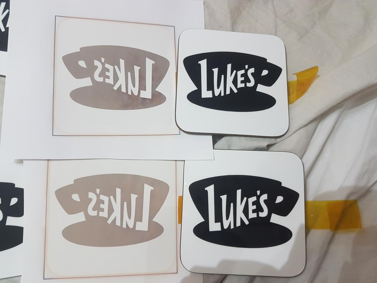

Thanks for that! I thought it wouldn't be heat related as half was coming out fine but I increased the heat from 200 to 210 and put and added an extra piece of copy paper under the coaster to increase the pressure and it looks a lot better!
There's still a little bit of a pattern on one side but it's much better so happy with that!
Thanks again!
