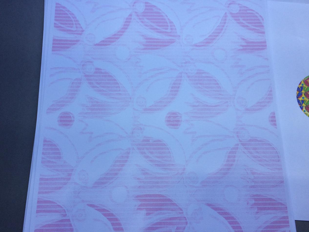

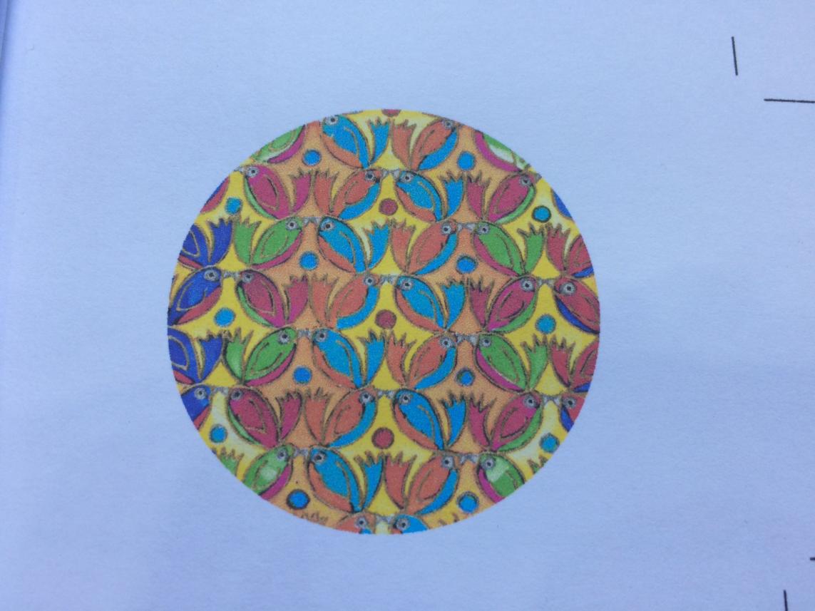

Trying to print image on left, getting (larger scale) image on right...
Argh. Anyone got any ideas?

Something seriously wrong here if the picture scaling is out. Probably not the inks or CISS system.

Hi Webtrekker - sorry, didn't mean to confuse the two: the scaling of the pic is accurate - I'm printing it out much larger to try to get the inks through the system (I was just trying to explain why the first image is so different to the second!).
